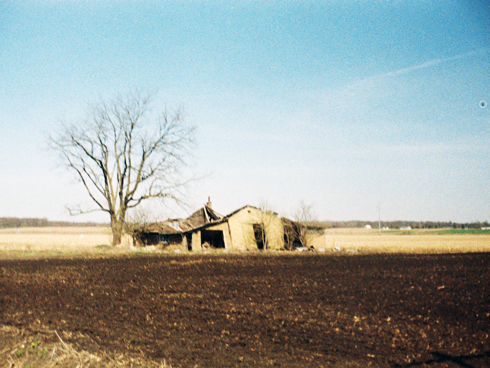

Just got a roll of Lomo 110 Orca B&W film developed by a local lab.
These 'spirit spheres' (makes it sound nice!) are through out the roll. Is this a developing issue from the lab? Or film defect?
Film was fresh. Shot on a Rollei A110.

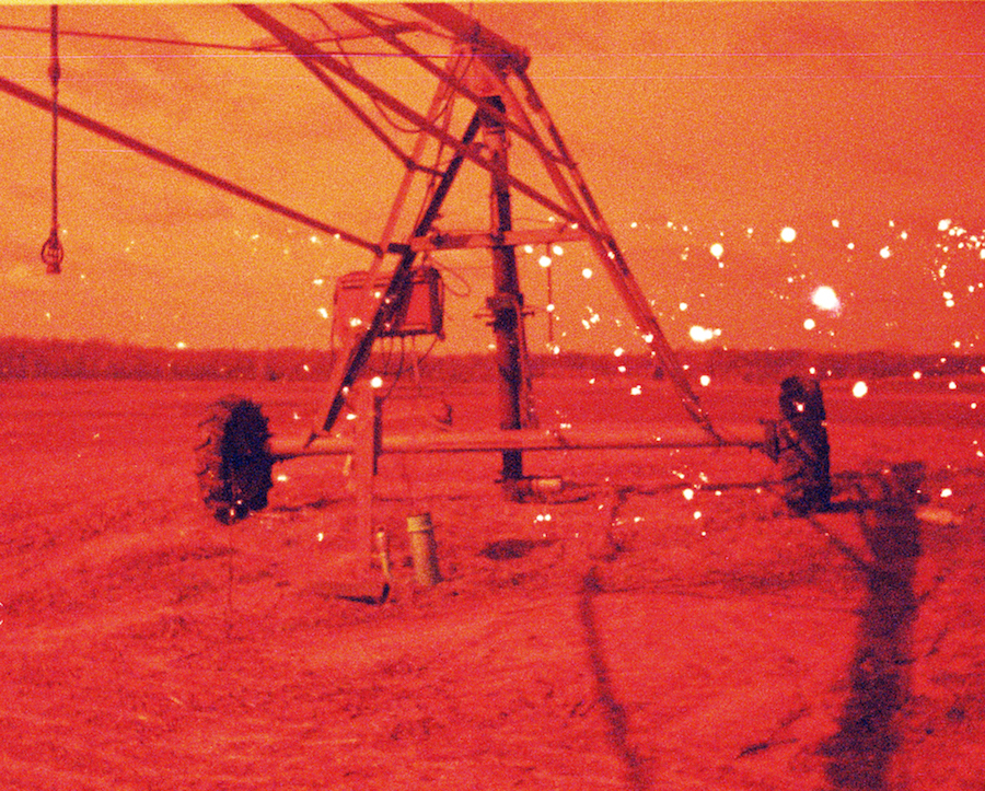

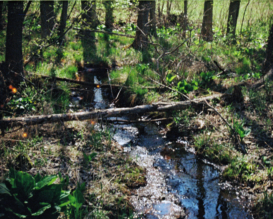

So I'm not the only one to have this happen, thought it was a camera thing.
The bubbles varied from image to image, but this one has it the most off this roll.
Now, this 2000 expired superia 200 was exposed in the same camera...
And here's a Tiger Roll off a vivitar tele 603. same as the lobster, I got spots and the amount and patterns were all different
And, I even had the same thing happen to a lesser extent on a peacock roll, but I ran that through a camera that would not advance the film properly, so I'm not sharing any of those images.
I'd be interested to know what this all is. I don't know how much 110 I'll shoot in the future, but it's interesting to know someone else is experiencing the same thing.

That looks to me like backing paper sticking to the film. I have seen this many a time( in the late 1970's) it was usually cause by poor storage.

I've seen this a lot with Lomo 110 film. It happened when shooting outdoors in bright light. The problem went away after I put some gaffer tape on the frame counter window of the camera. This suggests the problem is indeed tiny holes in the backing paper.

I'm betting this was the lomography film's fault. They have a lot of problems with pinhole defects through the backing paper. Cover the frame counter window with black tape and see if you still get these spots. I know with my pentax auto 110 I had this exact issue and a bit of electrical tape completely resolved it.
