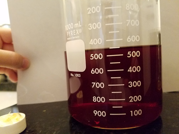

I tried making Poe Boy wet collodion, however I'm not getting any images. My silver nitrate and developer are good. When the plate is in the silver nitrate, it turns yellow as it should. My suspicion is that there isn't enough iodide or bromide ions in the wet collodion because I used potassium iodide and bromide instead of cadmium. Would adding some cadmium bromide and iodide to the collodion possibly save the batch?
The way I made my collodion was that I made the poe boy recipe in lab conditions with lab quality glassware and chemicals, then let it sit for a day and then filter out the precipitate. Right now the collodion is a deep red, even though it has only been several weeks since it's manufacture.

Here it is.

My buest guess is your collodion is too old. It's rather dark, I don't remember it has been so dark as it aged in my bottle. Aging collodion looses its sensitivity. Where did you shoot the plates, inside or outside? Lighting conditions? Exposure?
