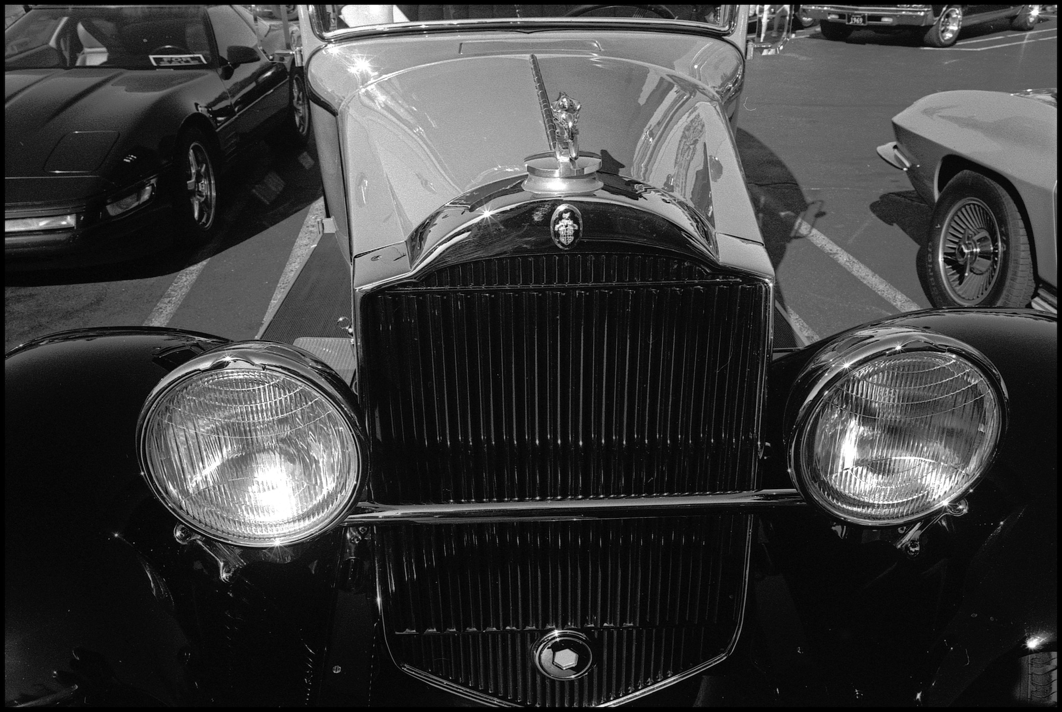

For what it's worth -- maybe you can extrapolate -- I've developed 35mm IR400 in D76 1:1, 71F, 15min total, agitate initial 15 sec then on the minute thereafter -- I swirled the tank without inverting on even minutes, and inverted on odd minutes. Examples attached.
