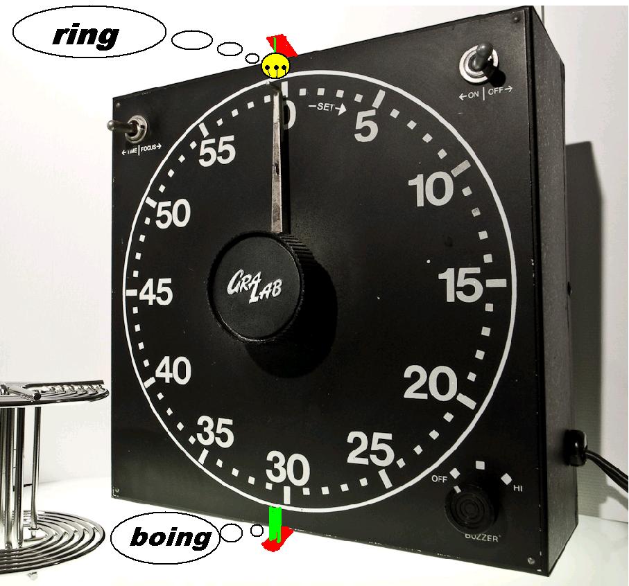

Ok, so I also use my classic Gralab enlarger timer when I'm developing film, sometimes in open trays, which means several minutes in complete darkness.
The glow in the dark is great and all, but it just doesn't cut it and I'm finding myself leaving the tray and putting my head 6 inches from the damn thing just to see when my 30 second agitations should commence!
Grrr...
I thought, golly gee whillikers, if I had some kind of simple audible signal my troubles would be over. And I don't mean a metronome that beeps on the second, which would drive me all the more bonkers.
So my question is, has there ever been a count-down timer that accomodates some kind of intermittent signal?
However, I think I've got a better idea...
I'd like to attach a dangling bell at the top, right above 12 o'clock, so that when the second hand passes it will ring it. Conversely, on the bottom, I'd like to have some thin piece of metal projecting upwards so that it will be "plucked" as the second hand passes. (kinda like a jaw harp)
I've attached a piece of Art (note the capital A) to better demonstrate this.
Whaddya think? :whistling:
Any good ideas for materials to do this? I can probably throw something together fairly easily, but specifically I'm wondering what a good metal might be for the all important boing, and I need to make sure it doesn't halt the movement of the hand.

I think it's an interesting idea. Though something that would make a loud enough noise might well interrupt the hands.
If you wanted to get into a little bit of electronics, you could possibly wire a couple of reed switches to the buzzer circuit so that the hand just brushes the switch and it would give a short little "beep" when switch closes then opens. It would be easier to implement, I think, if you weren't going to use the buzzer for anything else. (I don't ever use the buzzer on mine, much too loud and annoying).
Another possiblity might be using light, tape an LED throwie to the second hand; http://www.instructables.com/id/LED-Throwies/

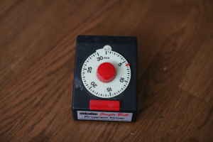

unicolor_timer_10_benson_midtown_7817752.jpg The simple "jingle bell" timer is kind of like that, but it won't keep running after the jingle, though. It looks like it could be easily modified to keep running.

I like the bell idea for low-tech.
If you wanted to get all fancy you could put a Dead Link Removed (they close when there's a magnet nearby, mouser at least sells them as small as 7mm) or three at critical places (with blutack!) on the face with a little speck of NdFeB magnet on the timer arm. Relay will be closed for a couple of seconds while the hand is adjacent, and that can be used to turn on a little 5V piezo beeper. And then of course you have a monstrosity of wiring.

That jingle bell timer reminded me of a similar one I had years ago. I forget who made it, but it had a way to set bump stops on the face to trip a bell at predetermined times in a sequence. You set the total time by turning the dial, and the trip fingers activated a dinger as they passed. It was explicitly made for film processing.

There appear to be as many ways to accomplish this as there are photographers! A lot of great ideas.
The reed switches sound like a really elegant way to go about this, but a bit advanced for my expertise.
Hey Rick, the timer your desribe with "trip fingers" sounds kind of like what I'm imaging. Can you recall anything more about it?
I see weird timers at antique stores sometimes that apear to have many "tines" arranged around the circumference... I have an inkling about them, but never looked close enough to say for sure.

You could totally do it. All you need is a reed switch or three, a battery and a 5V buzzer. Put your reed switches in parallel (so that when the magnet goes near any one reed, you get conduction) and put that lot in series with 5V battery (4 AAs in a holder or a plugpack) and the buzzer. The hardest part by far is mounting the reeds to the front of the gralab neatly and you'll have that problem with any ad-hoc method.
(it's easier than the mains wiring for your UV box!)
