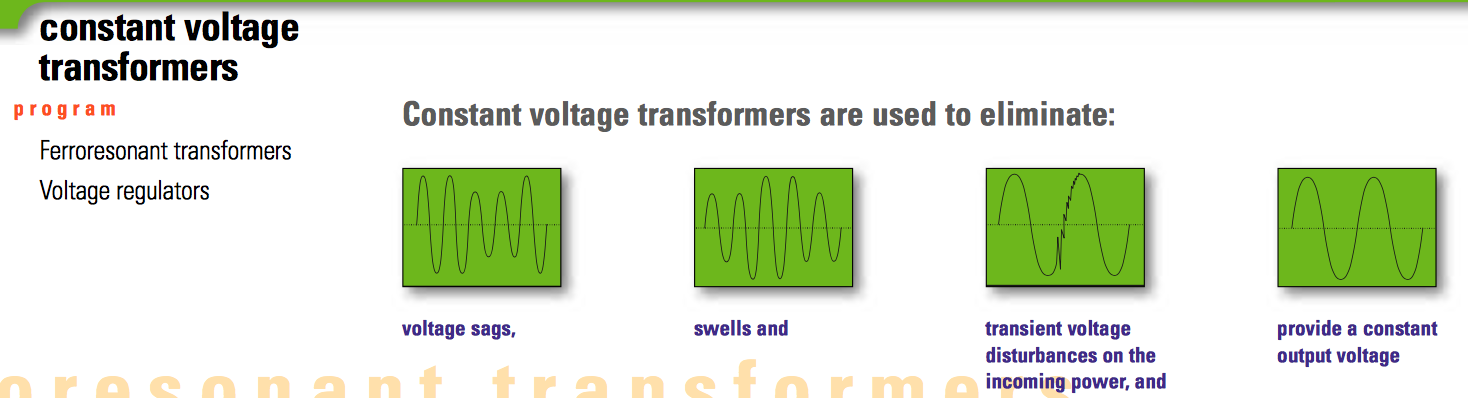

In the US, where Omega enlargers are manufactured, their halogen source enlargers were color enlargers and they had regulated power supplies with built-in triode switching (no relay as in the D5500). A halogen lamp with a simple transformer-only (and no voltage stabilization) would have been found on the older Omega power supply which came with its own appropriately spec'd timer which would handle the inrush current (Omega "Power Tower").
The third popular Omega circuit was used in the Chromegatrol which only had its own timer built-in, it used a constant voltage ferroresonant transformer which reduced inrush current.
I never saw a Durst use that type of transformer.

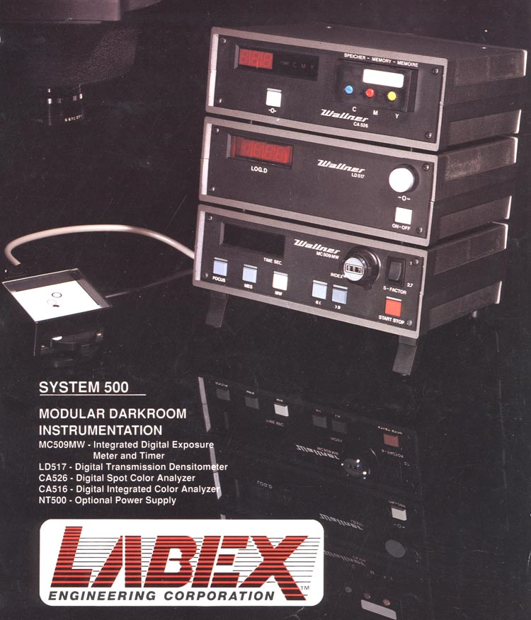

No, the Wallner 507 is just a (advanced) metering enlarger timer.
Back then it was the founding of the so-called Wallner Turret, consisting out of meter/timer, densitometer, colour-analyzer.
Wallner Turret (here with even more advanced meter/timer version 509 (w. 999 instead of 4 paper settings)
