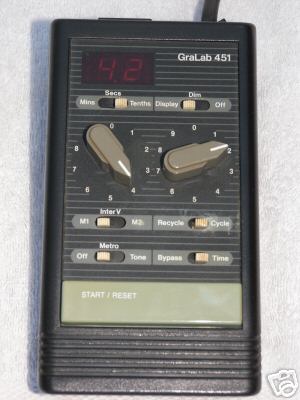

Here's the Gralab.
Paid $15.00 at a yard sale.

Our other timers are Beseler Digital timers...they are alright, but I have to send them in for repairs regularly. We have 19 enlarger stations, 125 to 150 students per semester, and besides the class times, about 75 to 80 hours of open darkroom time a week. Those buttons get pushed a lot! And often with wet fingers.
I am afraid the Gralab digitals would not hold up to the punishment.
They are surprisingly tough, we had one in my highschool yearbook darkroom and it never gave any trouble. Considering how cheap they can be bought these days if it lasts 3 years and then you replace it, its probably cheaper then changing bulbs.
