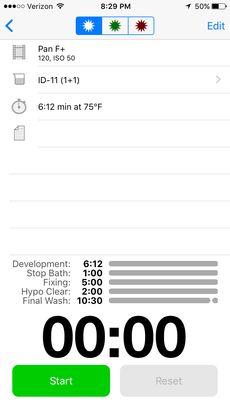

I'm going to be shooting some PanF 120 this weekend and according to Ilford's recommendation, they list 8 1/2 minutes with ID-11 1:1 at 68 degrees. Knowing that in most cases manufacturers list times that are too long on average and that I"ll be using 75 degrees instead I'm figuring perhaps 6 minutes may be a better place to try rather than their recommendation. I'll most likely use box speed.
Does this sound about the right place to be?

According to my app:
It's years since I have used Pan F but when I did use it I found it a rather fussy film in terms of both exposure and development. I often ended up with negatives that lacked a good tonal range and had harsh contrast. I'd suggest looking up the exact development times and only adjusting according to your individual results. I gave up with it in the end
