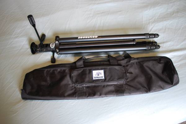

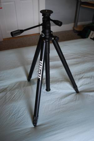

I've heard this recommended several times on here, but they don't seem to be for sale on the major sites.
I found a used one on Craigslist for $100 - is this the type of model you would use for LF? ideally, it would support an RZ67 or Calumet CC400. This doesn't appear to be super supportive, but I keep hearing the Tiltall name come up on APUG. Whats so great about them?

I have owned several over the years, all incarnations from the Marchioni Bros original, Leitz , and a few black ones like the one pictured, even a video model. They were the recommended tripod by Calumet for the cc-4xx model cameras, they are stout enough. I think $100 is a bit much for one, but you can always try to dicker. I sold my last two for $75 each, they were the modern ones, even had a QR adapter with one. Check this out:

The Tiltall in your photo lools like the smaller one to my eyes. These aren't for LF but they will handle a 35mm SLR, maybe a light weight MF. You'll be wanting a full size Tiltall---those are quite a bit longer when folded and can handle a CC400/GV2 and even a 5x7 Speed Graphic (I know---that's what I use!) Look for a Marchioni (sp?) or Leitz $70+ buck-ish ought to get you one.
