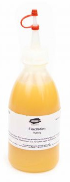

I am using this Kremer fish glue:
with this product information:
"Fish glue is liquid because the fish proteins must function well at water temperatures down to 4°C. Warm-blooded glues all gel at 20 °C at the latest. Fish glue is suitable for all applications where particularly high elasticity must go hand in hand with very high strength. A particular advantage is the great adhesion of fish glue to wood, ceramics and metal. Fish glue can also be used in concentrated form on cold substrates. Our fish glue is cooked from unrotten fish remains, which is why the smell of fish glue is not unpleasant. The 300 g are packed in a PE dispenser bottle."
Its' smell is quite discreet and not unpleasant. I can't tell you for sure what is it like.
The dilution I use is 2g fish glue/50ml liquid pigment.

OK. I haven't used Kremers glue yet, but I actually have it on order. I expect it to be a quality product. It contains both phenol and Sassafras. (Someone said that most fish glues come from the same source anyway)
I think you dilute it too much to take advantage of the phenol preservative. And maybe the thymol you add is not ideal for rotten fish?
I mix the liquid glue 1+1 with distilled water and add pigment. That makes about 23% fish gelatin. Your mix would contain only about 1.5% fish gelatin. That also means you have 15 times less phenol in your pigment mix.
Another benefit with the high concentration fish glue is that I don't see a need for a dispersant.
