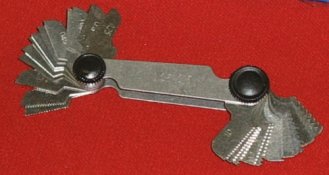

If nobody has a correct answer you may have to use a thread pitch gauge to find out. (Maybe borrow from a machine shop..)
These inside threads can be tricky to measure.
(I once machined with trial-and-error method a metal lens hood to my Mamiya-Sekor (1959) with a lathe and had to make a tool for it. If my memory serves me right this M40.5 thread had a pitch of 0.75mm and had an angle of 50 degrees.)
