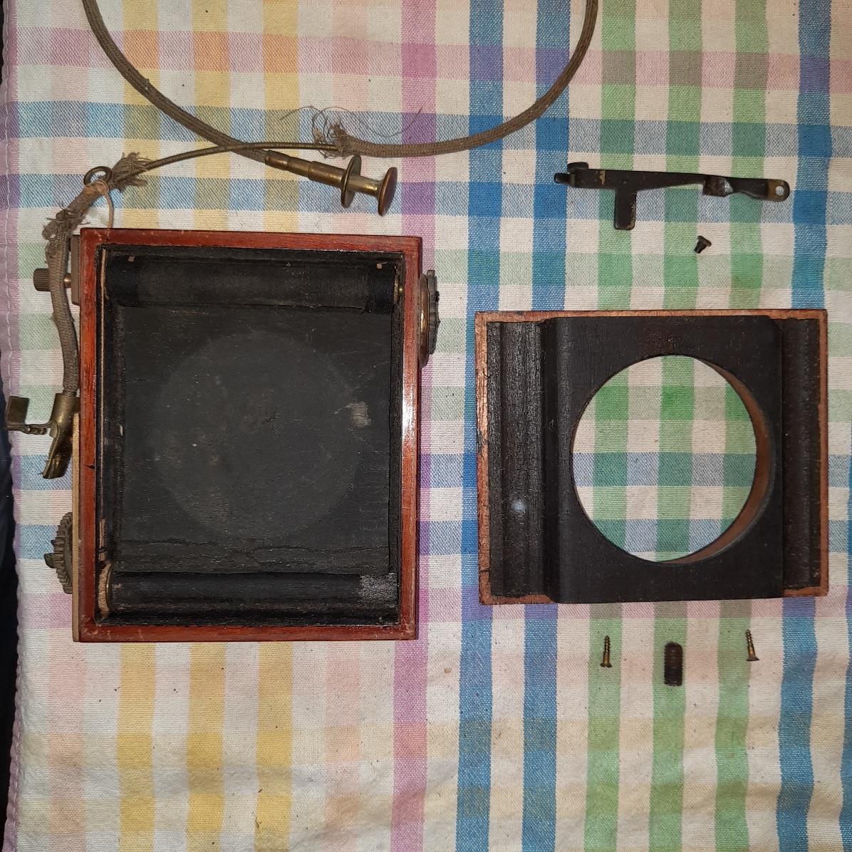

Hi

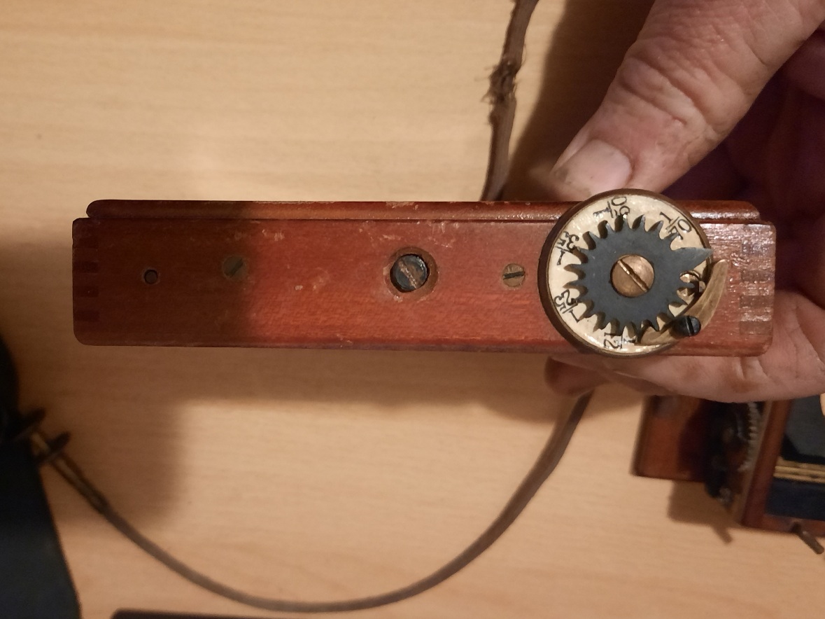

Just picked up another Thornton roller shutter, but cant work out how it comes apart. Is there a trick to it, my other one just has a removable front plate. There are a couple of screws on the speed dial side, do they need removing? If so I would assume there are screws on the shutter side somewhere.
Also I cant see any mounting plates and was wondering how it would be mounted to a camera.
Thanks, best ask before I start damaging stuff. 20200901_115125.jpg 20200901_115103.jpg 20200901_115006.jpg 20200901_114935.jpg 20200901_114847.jpg

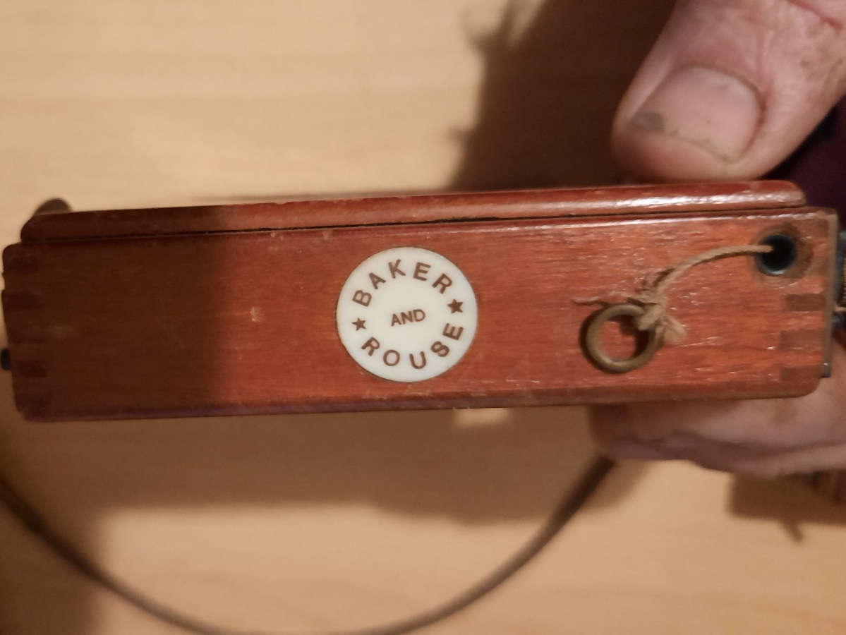

Two screws and the lens grub screw on one side.

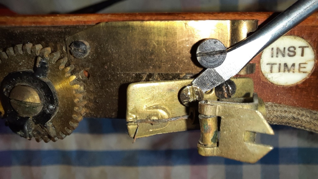

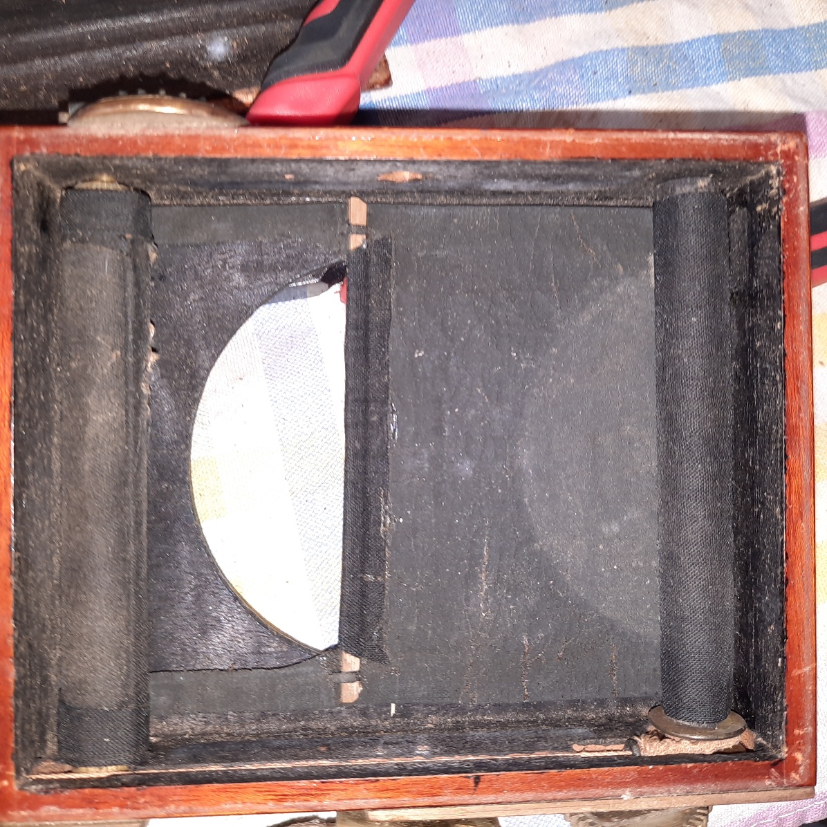

Looks like original curtains with some holes in the middle but no tares.....so far.

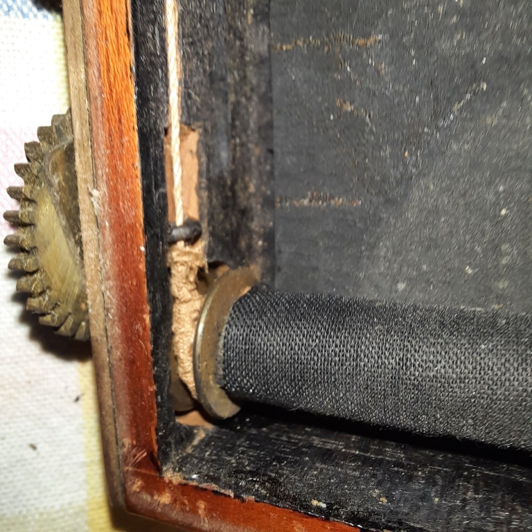

Pull cord has fraid and is preventing it from setting the shutter.
