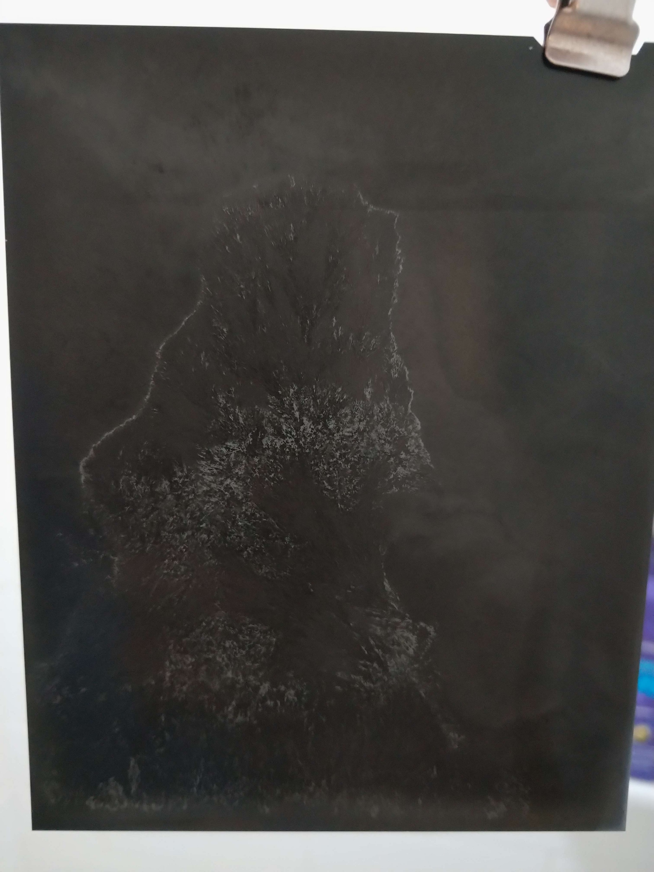

1977 Plus X 4x5. Open box, unknown storage, it was free. The shot shown was exposed at 20ISO, the shot at 40ISO looks almost the same.
HC-110, Dilution H (1:63), 12 minutes. Kodak Hardening Fixer, developed in a paterson 3 reel tank in a 3d-printed film holder.
Here's what the 20ISO shot looks like:

Not a good sign! I’ve shot similar era film with nothing but a small lift in base fog.

HC-110 usually is a good developer for aged/fogged film, but not this time it seems. I just tested two open boxes of 8X10 Tmax 100 and two open boxes of Tri-X Pro 320 in 8X10 that were 33 and 34 years old. All had been stored in various conditions like freezer, then fridge and then in an unheated non cooled garage loft. All the boxes had some form of water damage and two even have specs of black mold on the nice Kodak yellow. I developed them in ID-11 1+1 and while I don't have my densitometer here at the cottage it looks like there is very little fog, if any. What surprised me the most was the emulsion didn't show any defects as far as blotching, mildew or fungus.
Of course your film was a bit older than mine, but I think it has more base fog than it should, but like you said, "Unknown storage" and that could have been in an oven at 350 degrees. Sometimes you win and sometimes you lose. My loss record is much higher than my win record for sure, but you never know until you try.

Yep, no good. 1977 was a long time ago. Was worth a try I suppose. But nope. no good.

here is my 2cents, HC-110 is not a developer for what you need.
buy diluting HC-110 and longer time you got the opposite of what you need...
the old film needs a developer that is more high contrast [one that dose not affect unexposed areas]
BUT will develop only exposed areas try something like R09 a 1to 30 add sodium hydroxide solution + alcohol 15cc for every 350cc working dilution dev. and if need add Kbr2

Be that as it may, but choice of developer doesn't explain this amount of fog. So I'm with the others - this film is dead. It has expired and gone to meet its maker. It has ceased to be. It is pushing up daisies. It is pining for the fjords.

agreed. Was worth a try, but it's dumpster food.

Seeing that the boarders are pitch-black -Yes the film,it is a dead mule!
But then Some one like me -could use it for graphic art ----

Looks fully exposed to light and also water damaged. PlusX from 1977 would give an image if it hadn't been light-fogged, even if the film was moldy.

That was my take on it-no rebates at all. Heck the slide was pulled on one of these sheets and you can barely tell. Time to move on to the next box of film from 1977...the Royal X Pan 400...

Hmm, your comment about HC-110 puzzles me. I've read here, on these forums, the advice to use HC-110 to develop old film that had been left in old folders for 50+ years. Why? It was said that HC-110 was a very good developer for reducing the fog due to age. Now, I agree with you about the dilution probably should have bee dilution "B". The truth is I have never tried HC-110 for aged film myself so I can only repeat what I have read here. I have never read any replies to the discussion that dispute HC-110 being a good developer for age film.

No mistakes! Congratulations for the attempt.
You can print these for your local contemporary art show. You will just need to write a pretentious "Artist's Statement" about the passage of time, how your parents abused you by making you color inside the lines or that Kodak betrayed your like-long trust.
Every sheet will have different mold/crystallization patterns, so these are limited editions.

The statement is from the negative you show in the opening of this thread. I can not see the actual sheet of film.
HC-110 is a developer which gives a balance between the high-lights [dense] and the low dense area of the neg. [have used it -not for me]
In this case, a dev. that is able to dev only exposed areas - is needed - and where unexposed area will remain undeveloped - I would start from there.
if need be ??????
how the film aged ?? is it FUBAR???

If you can see the image in the thread opening, that IS the negative. It's not a scan-that's actually a photo of the negative hanging to dry.
The film is useless, the thread was just a double-check to make sure I hadn't done something bone-headed. It's time to open the next packet, take a shot or two, and see how they do!
Exactly.
It's an opened box of unknown storage. A UNopened box of that age, kept at room temperature, would have given you MUCH better results -- with any developer.
For all you know, every sheet was exposed to room light, and then stored in the trunk of a car for 48 years.
