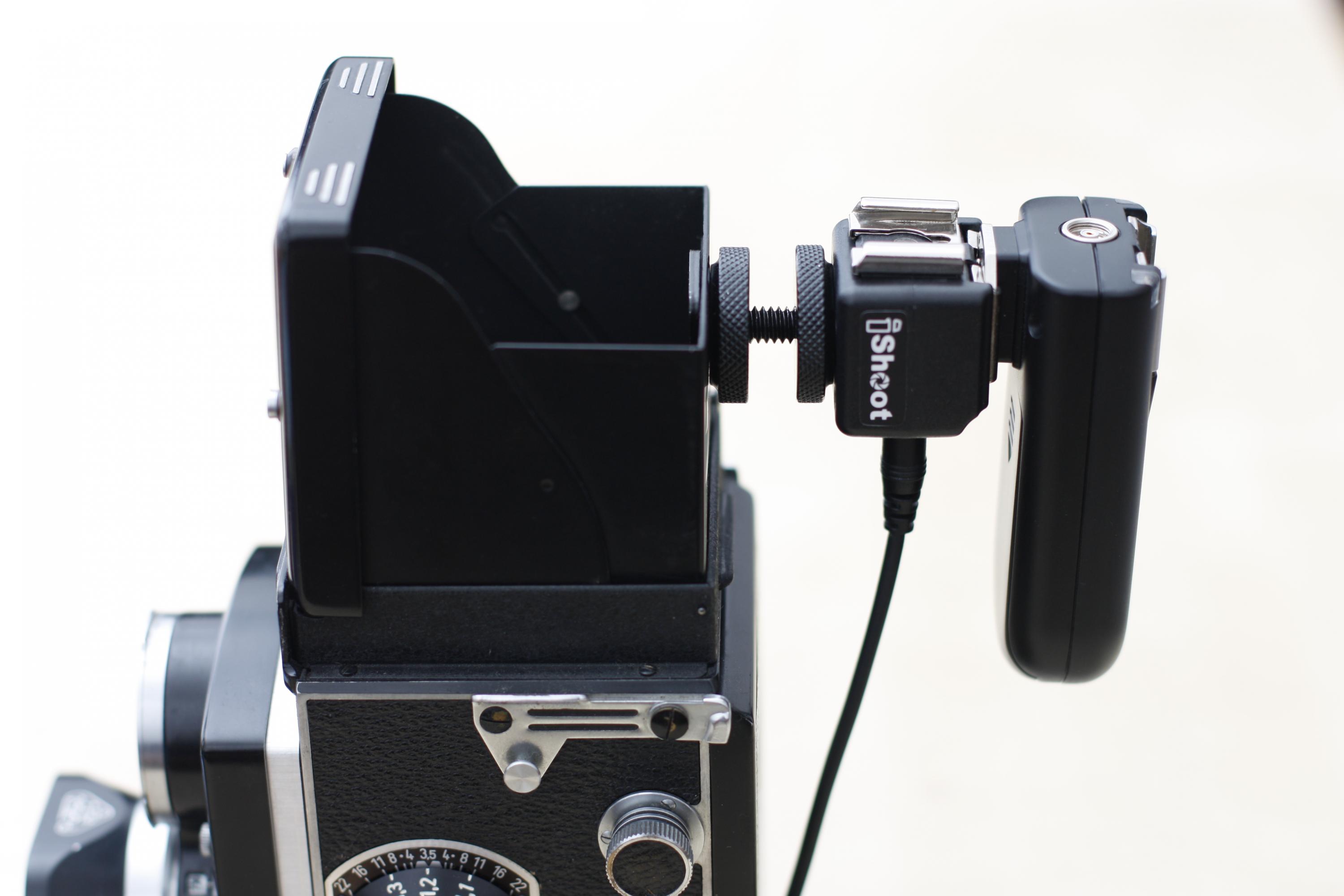

This is how I managed when there is no hot-shoe

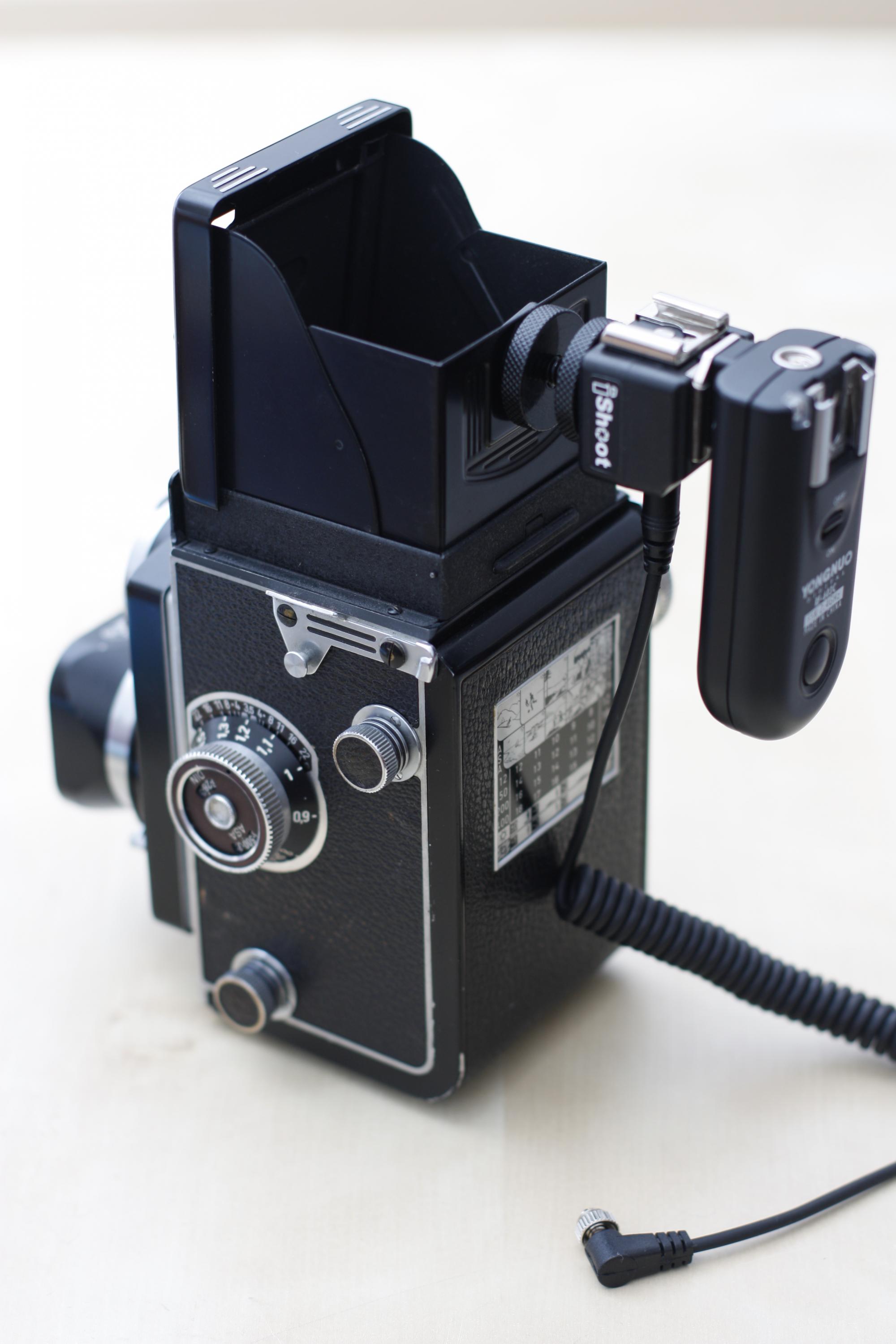

I may have to find a PC cable that locks to the PC port or go for some kind of mod to turn the old PC port to newer ones with screw lock.
Right now there are no washers in-between.
May be there are some clever ways to do the triggering...but I am happy with above.

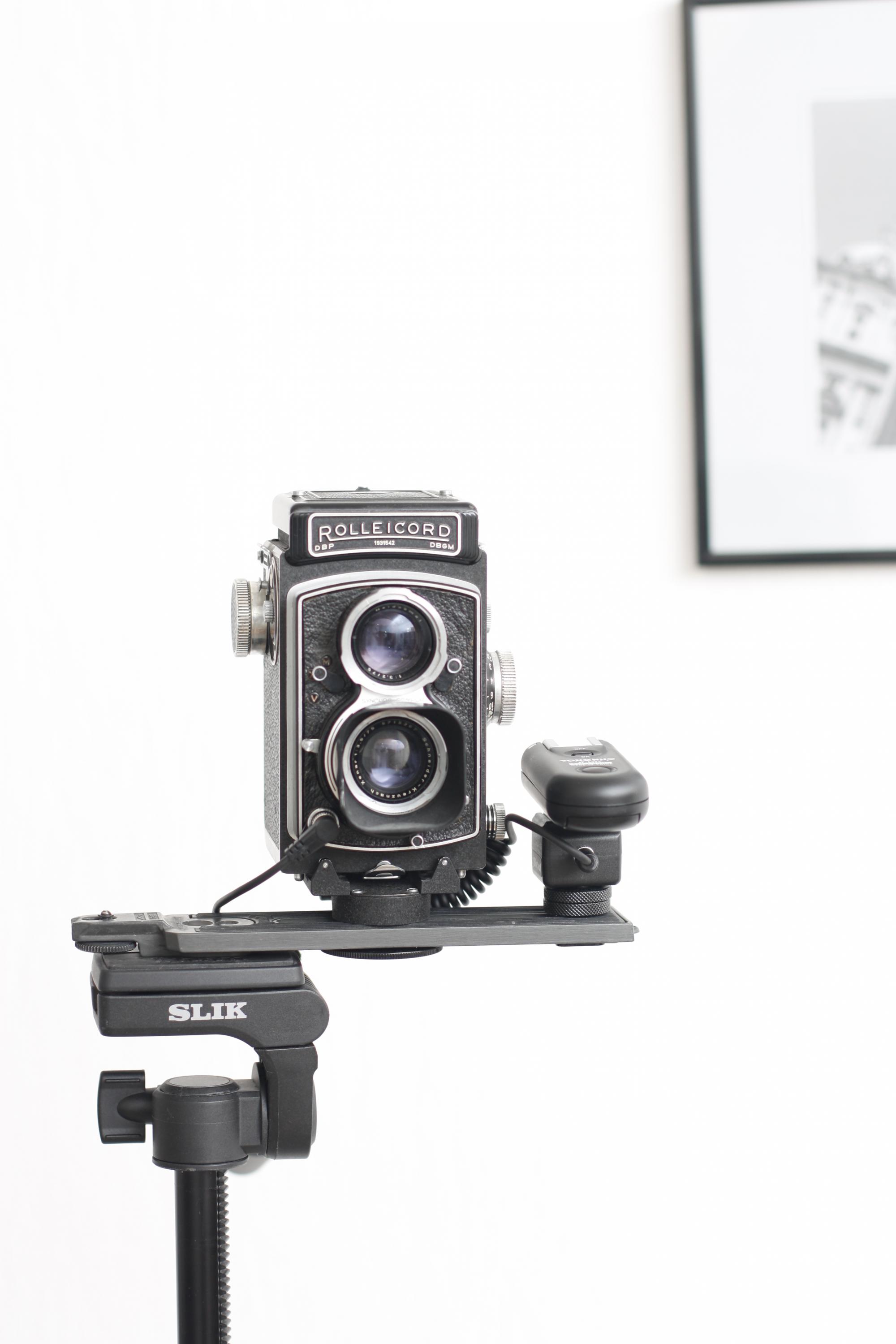

Right now rolleifix keeps the camera firm on tripod. I will try to get a handle and see how it goes.

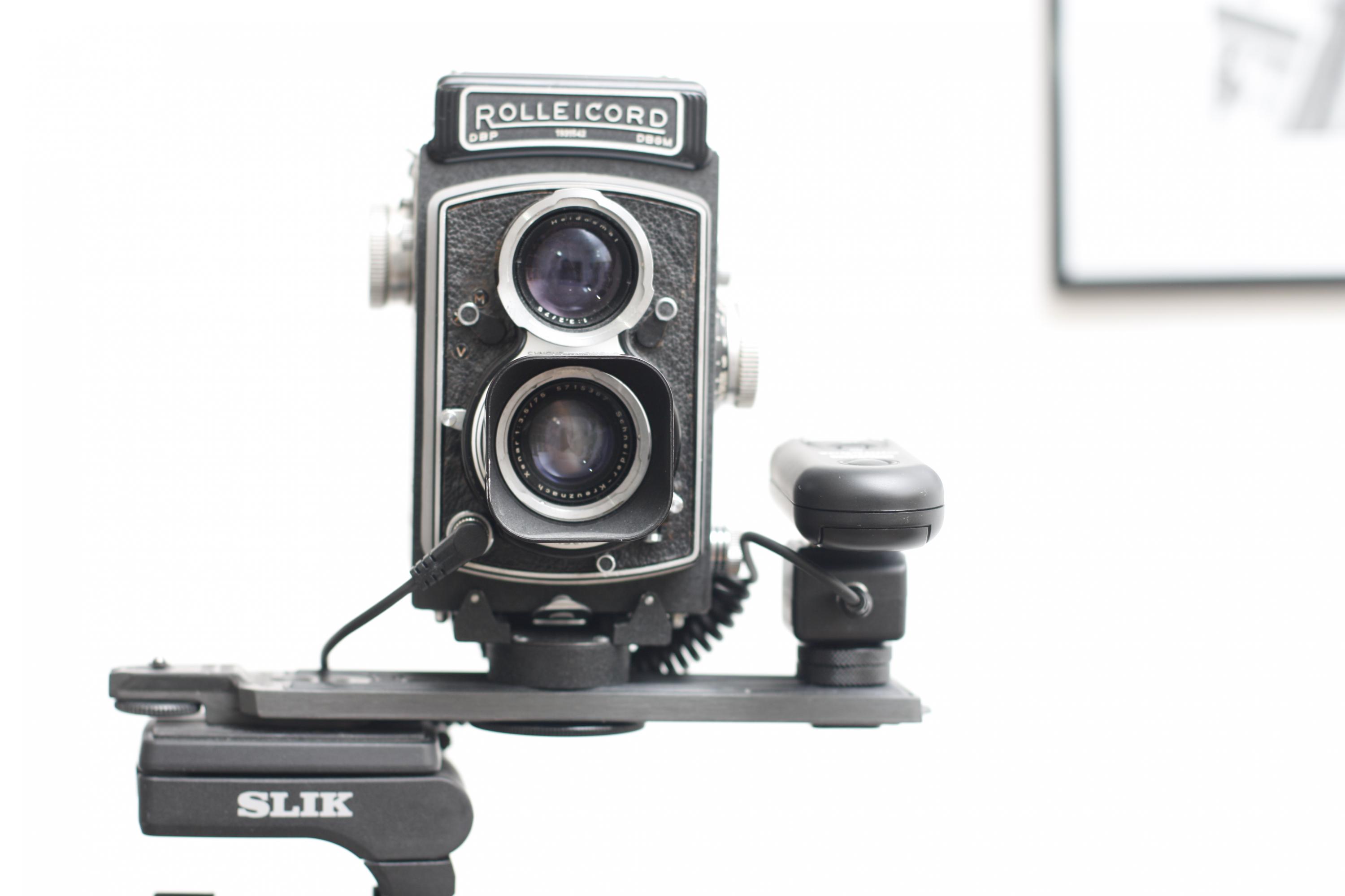

My idea was to keep things very compact.
In the past...
- Metz CL-45 with Rolleicord. Heavy and hard to focus. Never a clever solution.
- Metz CL-45 with Rolleicord on Tripod with Rolleifix. Not so pretty esp., in the house parties.
- Two Metz CL-45 with Umbrellas + Remote trigger + Rolleicord. Happy, but I need to pack the trigger somewhere.
Now, I am using either on Tripod or Monopod(when I try to take some photos of my new born).

Kind of happy now. Sorry to hurt the centiments for going unconventional way.

In case if you want a PC cord, you may get the plain cord that slips into PC port...

May be I am happy but still it is not compact yet...
