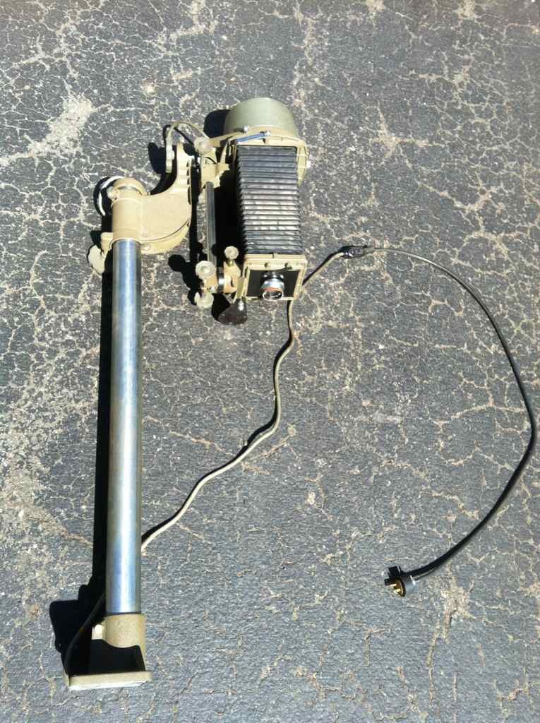

So got another moldy enlarger from a friend, however this one is a 4x5 enlarger, it's massive, and I would like to keep it if possible.
Here it is...

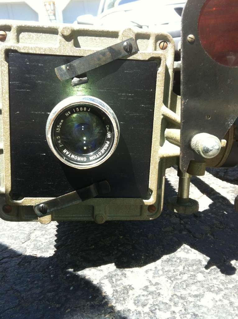

So the lens is pretty unrecoverable, the glass is moldy and the aperture blades are mangled.
I only have the 4x5 holder so does anyone know where to get the other ones?

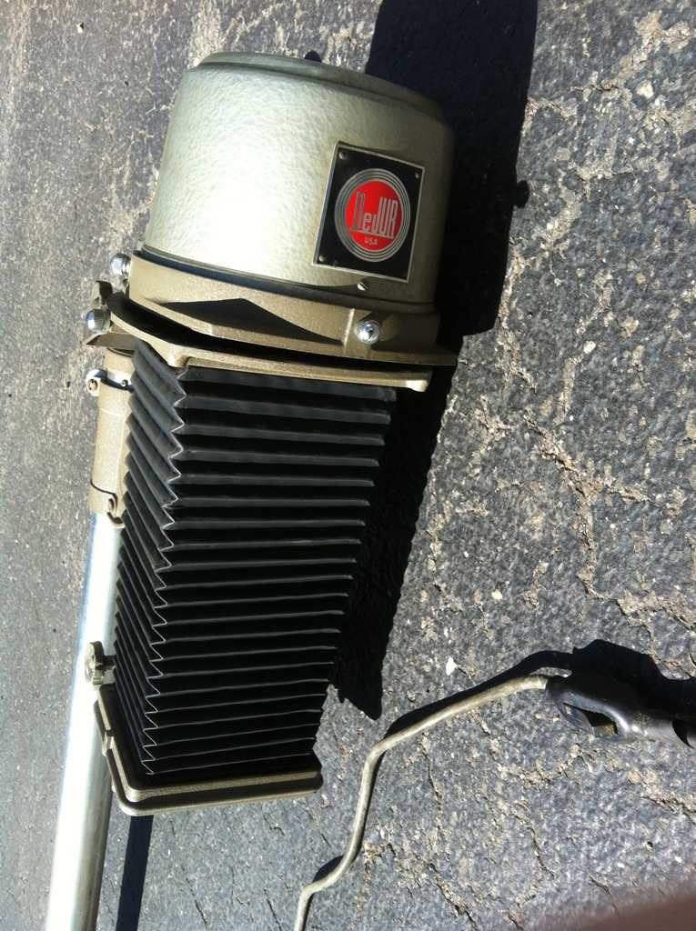

Can I get new bellows? It's big enough that I think I can take it off and put a new one on?
And I think I can clean the rest of it to make it safe not to transfer mold spores to film etc.
Are all the lens threads the same size? I already have a 135 from another enlarger, but that's for 6x7 right so for 4x5 I need 150mm?
I'm sure I'll have more questions at some point.
Any suggestions? It's laying out in the sun now hope that kills some of the mold.
Thanks!
~Stone | Sent w/ iPhone using Tapatalk
the 135 lens will most likely work for 4x5 also, depending on the lens. 6x7 is generally handled by an 80-105mm range lens. If the bellows are so permeated by mold that wiping them down with a rag soaked with dilute chlorox and letting them sun for a couple days still won't get rid of it, worst case scenario you can make a new one in a couple of afternoons worth of cutting new ribs and gluing them to some light-tight cloth. There are patterns out there on the internet you can download to help you figure it out. If you're feeling a bit more flush with cash, you can probably contact one of those Chinese bellows-makers on Ebay and order what you need. Any other accessories you'd want for this enlarger would most likely be sourced on Ebay, with a lot of time spent hunting them down. You can make carriers for it out of black solid mat board, and lens boards can be made from 1/8" plywood. You'll need to make a baseboard, which you can do out of 1/2" plywood.

A 135 will definitely cover 9x12 cm but I think it would cover 4x5" too. Bellows can be made, there are a few resources out there on the 'net.

The column height is a significant factor in how big an enlargement you can make. The taller the column, the greater the potential magnification. You should be able to print up to 20x24 with this using the (home-brew replacement) baseboard. If you wall-mount it and project onto the floor, you can probably go quite a bit bigger than that. The 4x5 designation has to do with the maximum negative size, not maximum print size.

But looking at your first picture, I suspect that the head can be turned 90 degrees to project on a wall or vertical easel. In that case, the size of your darkroom is the limiting factor.

The focal length of the lens is a guide to what size negative can be used with it. Many 135mm lenses "cover" a 4 x 5 negative out to the corners, while a few only "cover" a smaller negative. By "cover" I mean that when you look at the print, the corners of the image aren't darkened, and the details of the image at the corners are sharply resolved.

Wow lots of info, ok the height of the enlarger from the baseboard to the tip of the lens glass if bellows are all the way up is 0.93 meters and fully extended down is 0.68 meters.
Yes the projector head swivels 180 degrees (or more I didn't want to pull it out to see but at least goes to a wall, probably could do the ceiling too) both the top of the bellows near the light, and bottom adjust up and down, and the front (bottom part with the lens board) tilts, which is fascinating to me, so you can adjust for tilt issues from a shot??? Not sure...
So it sounds like its a pretty good enlarger? But the "bulb" is actually a florescent element behind frosted glass, which seems weird, as I would think fluorescents would possibly flicker and be inconsistent?

If you decide to stick with this one, You'll need something thicker than ½" for a baseboard. I'd use ¾ ply cradled with strips of ¾" oak. Laminate a piece of white formica on top. Getting the enlarger to 150º for a half hour should kill the mold. http://www.ehow.com/how_6692498_kill-mold-temperature.html
