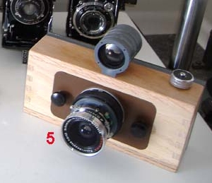

As some of you probably know, I have been building a 6x12 format camera with a Super Angulon 65mm lens (details in the link at the bottom of this post).
On Sunday I took it out for its trial run with a roll of film. I got home and processed the film.... opened the tank and was presented with six very black frames!
I looked at the camera to try to work out how the light was getting in. I decided that it was the material which I used to make the lens board out of. Although it looked opaque, it must have been passing some light so I stuck some film backing paper to it and went out again last night with another roll of film. This time..... another six black negatives!
I spent a bit more time looking over the camera last night and eventually found the problem. I had used part of an old Olympus lens as a focusing mount and there were two narrow slits allowing light in. I could only really see it by holding it in front of a bright light and moving it around.
Today I filled those gaps with some black silicon and took it out with a third roll of film. The result.... six wonderful wide angle images which I will print, scan and post in the next few days.

There is a link to a webpage documenting its construction in my signature line below.
I will add a finished picture soon. I still have to make a replacement back out of oak so it matches the rest of the camera. It will look better than the grey PVC back it currently has.
Steve.

I love those pictures, would like to see the camera.
Click on the link in my signature line for the construction details. I am going to re-make the back out of oak so it matches the rest of the body.
Meanwhile, here is a low resolution picture of it in its current state.
Steve.

Steve, brilliant finger joints, well at least from the low res picture anyway.
Nice looking camera as well.
Mick.
Unfortunately, I can't take credit for the joints. At work I have the use of a CNC drill/router intended for printed circuit board manufacture. I use it for various other 'projects' too!
Steve.
I have attached a better picture. Ignore the gaffer tape holding on the viewfinder. this will be sorted out soon!
Steve.

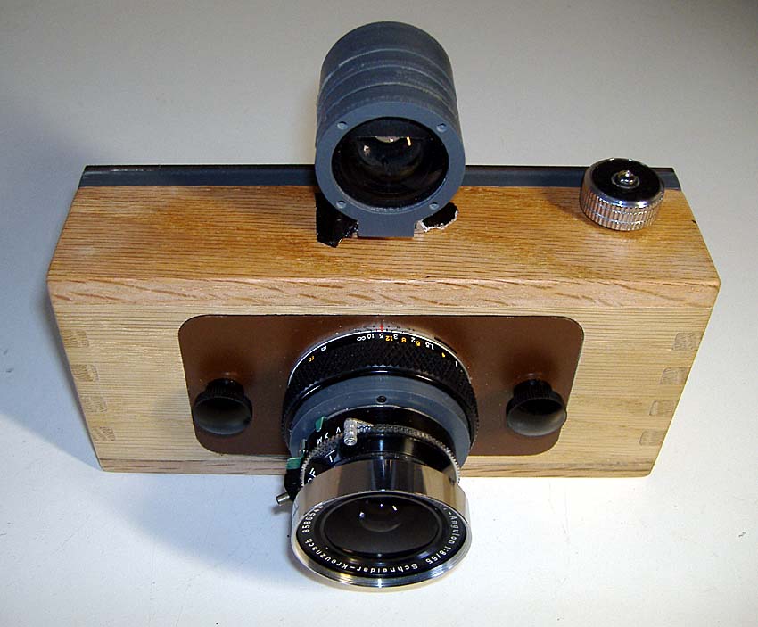

Well, fairly soon by my standards!
Today I tidied up the viewfinder with a bit of waste water pipe and a few pieces cut on the CNC router. I think this might be the point at which I declare it finished!
Steve.
