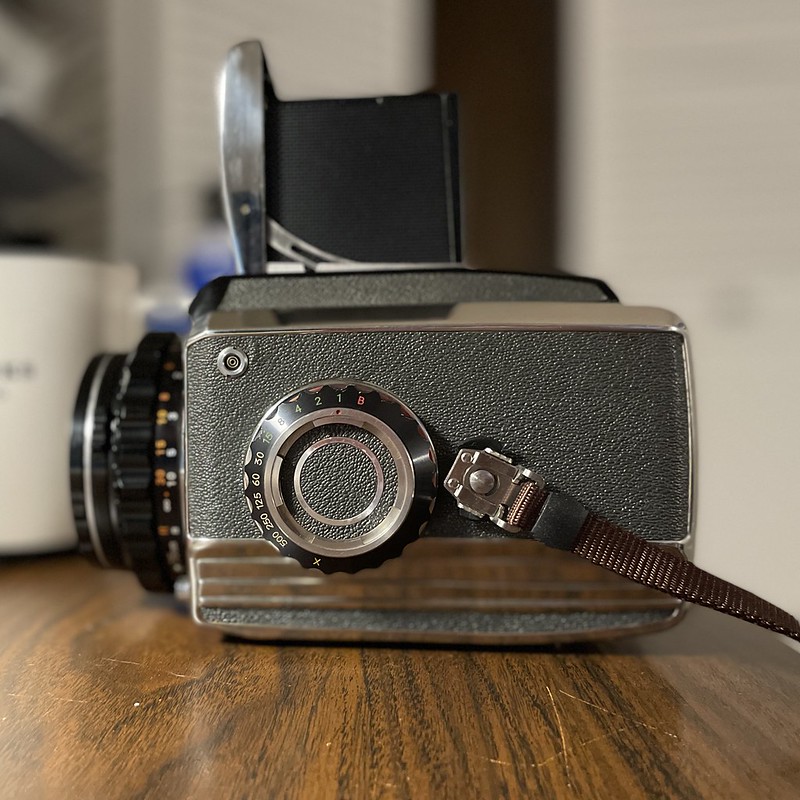

I went the C which is a C2 actually with 1/1000th top shutter speed and a switch to use 220 film. So, I like the way it feels. Viewfinder on this one is pretty bright and so far I don't think I'll switch out the GG for an Oleson. I'm sure the foam needs to be replaced but I don't shoot wide open often and am usually around f/8-f/11. I'll take it out for a shoot soon and see how it does, but dry fire the shutter sounds about right. Oh, and I'll need to address the light seals in the film door if I'm to use 220 in this camera which I will when I go on vacation. I'll probably send it to Frank Marshman for the mirror foam and rear door light seals.
The strap connectors are from a Mamiya camera that came with a Mamiya strap. I use it on my Fujifilm GX680IIIs, but for now they work fine on the C.

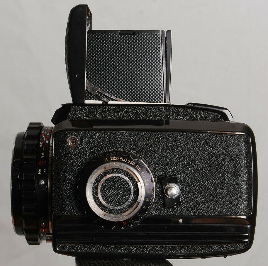

Apparently some C's had the 1/1000 speed marked and some didn't even tho it was available. Odd.
