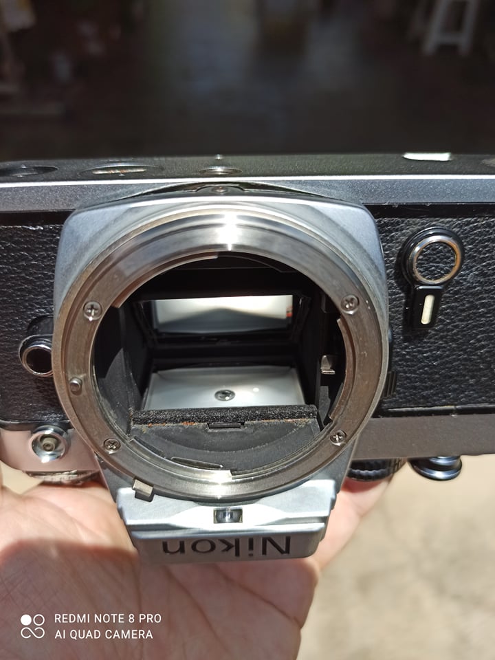

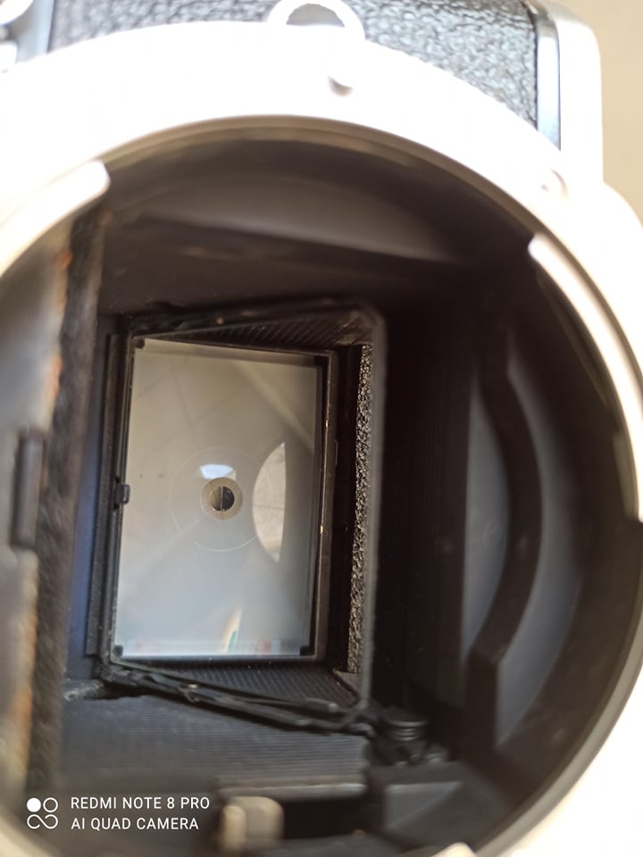

So, I've been trying for the last few weeks to buy a camera. I've settled on this (very cheap) Nikon FE. It's very similar to the FM2 I also found for sale and way cheaper. Although I do have some misgivings about it not being totally mechanical, it seems like the best option between the two.
Problem is, I'm not buying it from a specialized shop. So I thought about coming here and asking you guys: what should I be looking out for? The guy who's selling it to me send me a video of the light meter working (ISO 100 - 1/125s, f8, on a sunny day, half shadow, half light being framed - according to him). But should I be careful about anything else? I've also asked for pictures of the mirror, and it seems OK, but I'm not sure I can actually tell.
There're also some small spots of rust, how should I go about getting rid of them? (or just making sure they don't get worse)
I’ll attach all relevant pictures bellow. (well, there're a lot of them, but please bear with me)
As always, thank you!

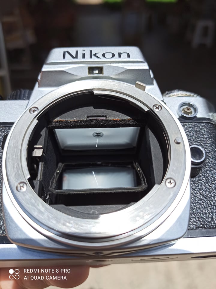

Looks like there is rust inside the mirror box. Which suggests there is corrosion elsewhere where you cannot see. What kills these electronic cameras is internal corrosion.
If it was me, I'd never buy an electronic camera that shows corrosion.

Hmm, is there any way I can be sure the corrosion isn't only on that outer part of the mirror box?
Anyway, I guess I can invest a little more money and get the FM2
Don_ih
Jan 24, 2021
7,491
Ontario
No.
There's also no way you can be sure about the FM2. I have an FE and an FM2. The FE worked when I got it, the FM2 didn't, both looked more-or-less new.
If the camera is cheap enough and seems to work, get it and use it. The FM2 will take the same pictures that FE will.

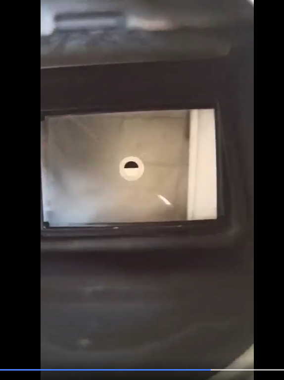

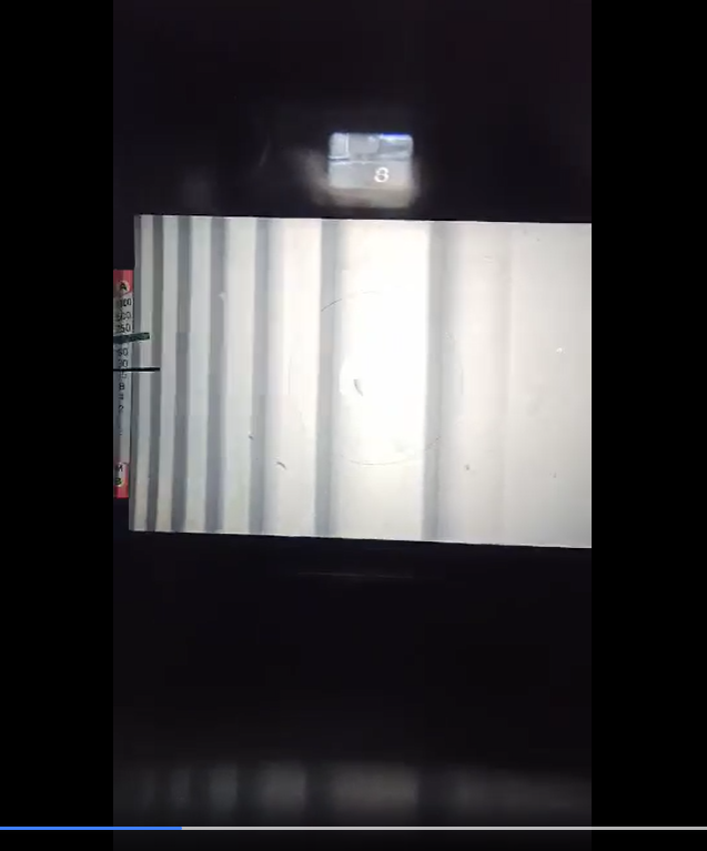

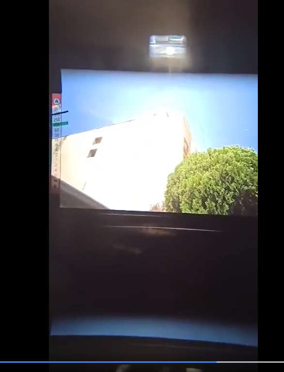

Put new batteries on it. Test that it fires at all speeds. Remove the lens, open up the back, point the camera to the sky while looking at the curtain, fire at 1000 and check that the exposure is even.
Put it in AUTO mode, with a lens fitted in. Check that the speeds vary according to light.
Now for the ultimate test -- sometimes the FE fails in a subtle way: you take in AUTO mode many shots at a low speed, say, 1/8th, yet one or two of these fire at what looks like max speed (1/1000). Try doing this test... put it on AUTO, low light condition so the needle marks 1/8 or so. Fire it many times and check that the slow speed fires ok.

There are not much steel parts visible at modern SLRs, aside of the back door. What you see at the mirrorbox may be corrosion caused by the deteriorating mirror foam, which though typically is not reddish. True rusty patches inside a camera should warn you more than such at a back door.

The rust doesn't appear to be coming from the foam, though. Still, all the functions of the camera are working alright. Suppose I get it anyway, can I send it to be cleaned, so the corrosion on the mirror box doesn't get worse? Or chances are the camera's all rusted inside and will stop working at any moment?
Paul Howell
Dec 23, 2004
9,574
Scottsdale Az
Always a possibly, cameras with electronic shutters can die at any time without or with any corrosion, just the nature of the beast. Otherwise a good clean lube and adjust is always a good investment.
I see the reddish areas near the mirror bumper foam but it is unsharp so I cannot determine if it is rust. I can't see how it can be rust as that part of the camera is made from a cast aluminium alloy - corrosion would not be red/brown but white/grayish.
Some types of rubber cement dries up brownish and it may be a sloppy DIY job replacing the foam.
I would want to see a sharp photo of the area around the mirror bumper foam. I would also want to see a photo of the battery chamber to determine if there are signs of batteries that has leaked (I would never buy an otherwise functional electronic camera with signs of leaks in the battery compartment as the chemicals migrates and will in time do damage where you can't see it)
A competent disassembly and inner cleanup of such a camera is a time consuming thus costly task and then you don't have a cheap camera anymore.
Being a happy Nikon FE owner since 1982, I can see that the camera you have there has lived rough life, and if I were to spend money on a repair of any of my FEs, I would only consider it on a cosmetically nice one.
If it is really cheap and works then then I would probably just get it and use it as is. It is not a lesser camera just because it shows wear and tear - as long as it works. You can do a lot of surface cleaning yourself with a little alcohol and a few cotton buds as long as you know what NOT to clean.

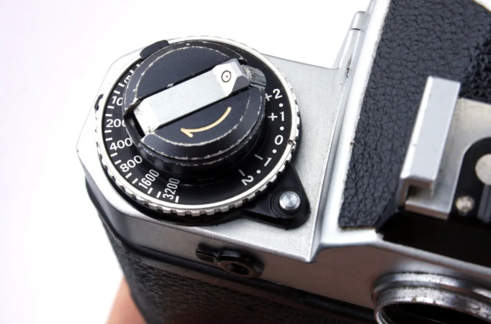

The image of the shutter speed dial would raise concerns for me personally. There is rust pitting on the metal strip around the dial where it meets the camera body. Likewise on the film advance lever. Also around the viewfinder.
It makes me wonder where it has been stored in the past (for longer period of time) and what is the inside like. I would seek expert advice if possible from someone who has worked on the cameras to see if those observations matter at all or not.

It has water damage - that's something that can't be repaired, especially in an electronic camera. Not worth anything unless you need some replacement screws for another camera.

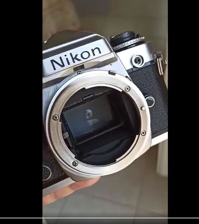

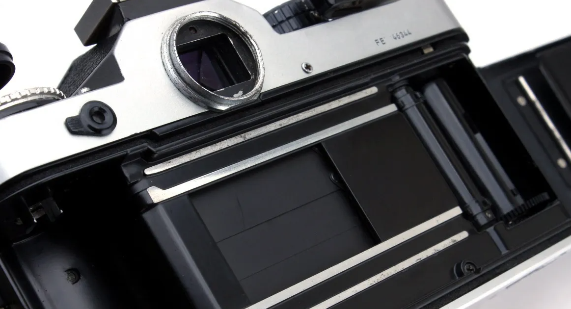

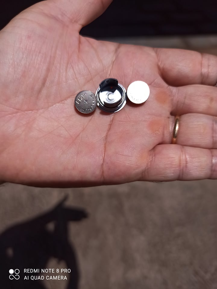

OK, here are the new pictures the guy sent to me. He agrees that it looks like it's old glue from the foam. He also sent a picture of the battery compartment, how does it look?
About the eyepiece, can I live without it? Or buy a replacement?
Nikon F's were famous for shrugging off water; there is an apocryphal tale of a National Geographic photographer smuggling his cameras into Chinese occupied Tibet at the bottom of a water skin, just shook 'em dry and started taking pictures - but I don't think that applies to the FE.
Can you expand on that? Why does it look like it has water damage?
Eyepiece: Most FE's and FM's has lost the rubber eyepiece. I wear glasses and wouldn't live without it. Some people don't even know it is missing and are perfectly happy. If you know it should be there you can use it to improve your bargaining position.
The battery compartment looks fine.
I don't think the brown goo is rust and the foam looks too "fresh" to be original from pre 1983 thus I think it is residual glue from replacement foam.
As someone else noted, there seem to be some corrosion thorough-out some of the metal surfaces. Are you OK with that?
Well, there is corrosion all over the camera. Not just in the mirror box. As you can see in the pics.
There are so many good cameras out there, why fixate on this one?
