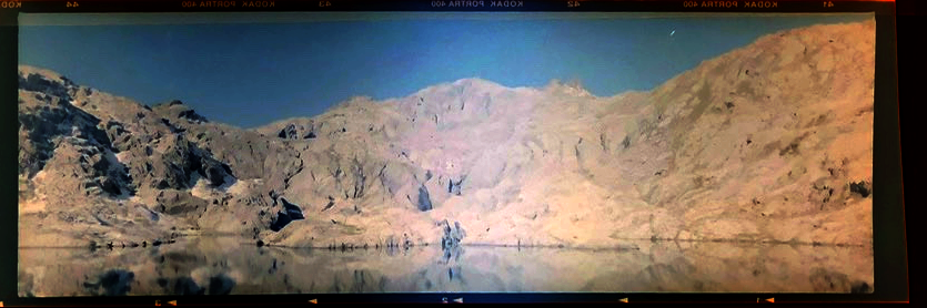

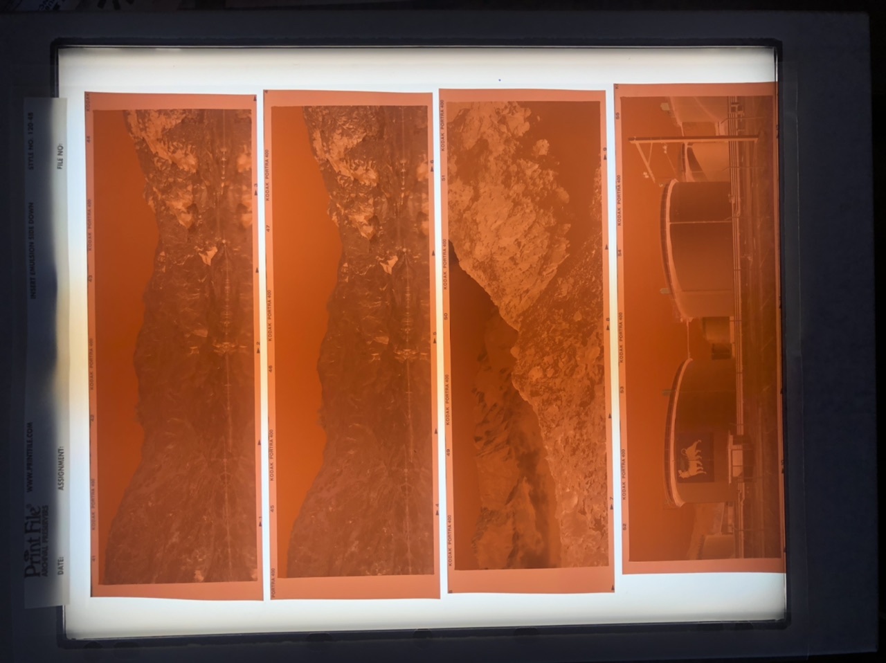

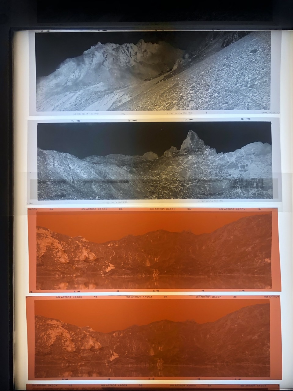

I have the impression my color negatives are a little thin - especially compared to my black and white negatives. How should they look?
Just to eliminate some variables :
I shoot 2/3 box speed
I use a pentax digital spotmeter to measure the darkest areas and place them between zones 2 and 3.
My 3 light meters all measure within 1/3 stop
My lens shutter speeds are all accurate.
All 2 dozen rolls are roughly the same and processing was done by 2 different labs.
Paul

Those look like excellent colour negatives to me.

Well, I worked for a time as a colour printer. The negatives that printed well back then looked like that.
And the colour negatives (Portra 160) that I get back from the lab now that print (unfortunately infrequently) or scan well still look like that.
Remember that colour paper and black and white paper are designed with different contrast, so the films for them are designed with different contrast.
Have you tried creating prints yet from them?
I never used Ektar 25 - don't even know that I've seen Ektar 25 negatives in the flesh - but I would be reluctant to base my impressions on the appearance of negatives from that film stock.
A very, very quick bit of post-processing of the screen shot gives me this, which tells me that there is lots of detail to work with there:

By the way, I really like what you have there!

@fatso those look about right for colour negs. The visual density differences you are seeing vis-a-vis Ektar 25 probably owes much to the replacement of the yellow filter layer with a special dye rather than Carey Lea Silver. If you're using the shadow keying you describe, you can use full box speed & you'll automatically get about +2/3 stop exposure.

Lol - that's the first image I've seen from the series ;-) I haven't printed any but will eventually scan them once I find my scanners power supply..
Your colour negatives look fine to me, although certainly not over exposed. I've had C-41 frames that I've thought looked slightly thin but have printed or scanned without difficulty. I use a Pentax Digital Spotmeter as well for medium and large format and find it gives good consistency of results.

Depends on the contrast of the specific film involved, as well as the scene. But based on my screen, that does look fairly typical for Portra 400. Portra 160 often looks thinner because it's lower contrast, while Ektar often looks thicker due to its higher saturation and contrast. The intensity of the orange mask also varies somewhat from film to film. What I like to do is place my color negs on the lightbox and view them through an 82B med blue filter, which visually neutralizes some of that orange and allows me to evaluate the actual contrast level and dye densities more easily.

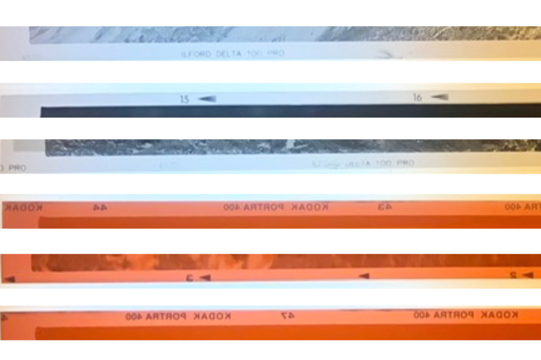

As has been said, they look good.
A simple and quick rule of thumb is to check the edge markings and see if they are good. (edge markings are factory exposed so if you can read them and they look good then usually the processing is good).
See this sample here.

AS said by others: they're supposed to look thin! RA4 paper, which C41 film was designed for in the end (or vice versa...depending on how you look at it) is very contrast; think something like grade 4-5 or so. A direct comparison between C41 negatives and B&W negatives can be very misleading due to this.
