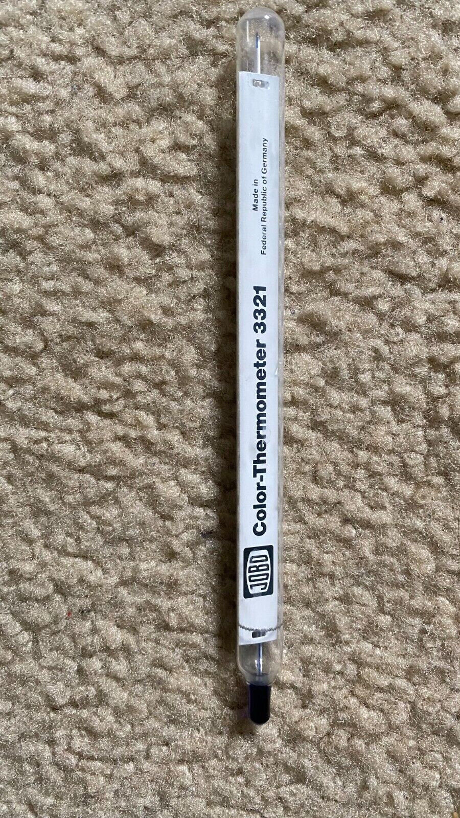

I use dial thermometers that I check against Kodak thermometers.
These little Jobo thermometers are fabulous, available used, new if you can find one.
