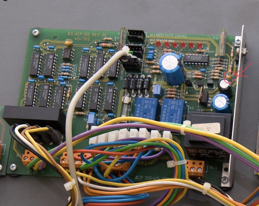

Some additional photos:
Above: the reverse of the thermostat board
Above: this component connects to a knob that controls the temperature of the developer and bleach fix baths. This device produces a mechanical 'click' sound when the knob is turned through a certain point.
Above: I'm not sure what this component with the screw is.
Tom.
Tom, the last device is an adjustable resistor or potentiometer. But in contrast to the more common ones it is not of the radial but of the axial type.
The use of a threaded spindle allows very precice adjustments. It is called Trimpot.
Hi Tom
I have and still repair these machines and all the Thermaphot range and other processors all around the uk. The trimpot is to adjust the voltage to the heating fan(23.5 volts.) Your heating problem could be one of the relays on the thermostat board. When you switch the machine on the mechanical relay should make contact and by turning the thermostat until it "clicks" the relay should disengage. On initial warm up the voltage at the heaters should be 240v, and once up to temperature this reduces to 80v. I hope this helps and good luck. I can supply any parts needed.

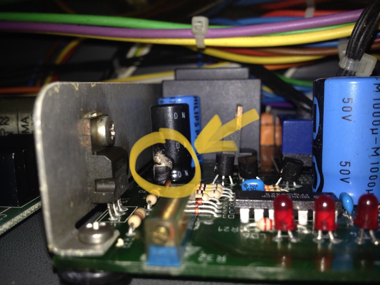

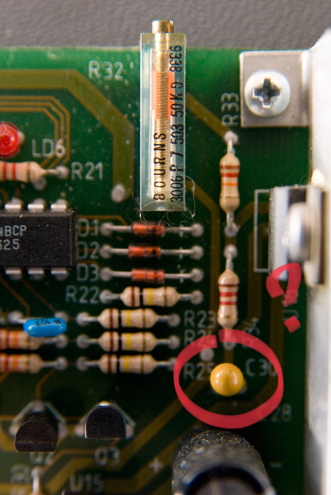

Hi guys!
Please help me! What capacitance is the yellow capacitor???
It should say so on the capacitator itself, even if in coded form.
Or did yours burst?
