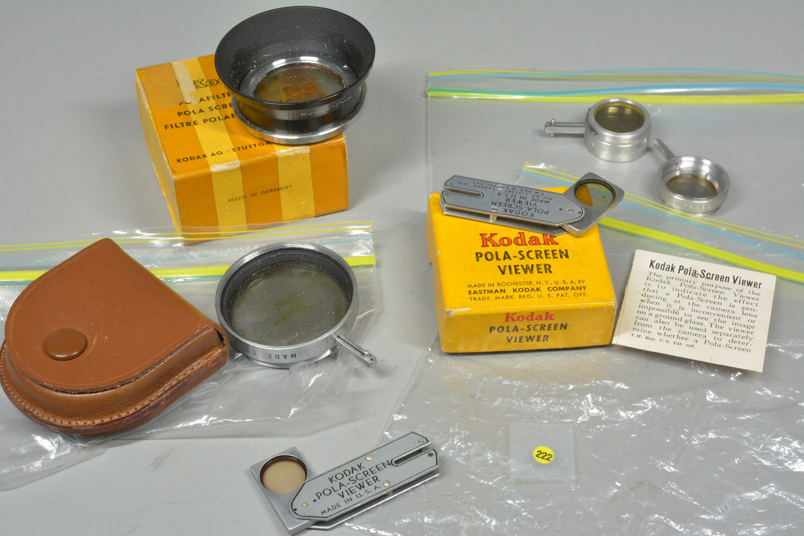

Isn't the longest lens available for Leica a 135mm? They didn't make zoom lenses for them. Using a polarizer is slow but can be done. You would have to set it and then put it on the lens.

As for polarizer, Leitz made a lens shade with polarizer. The filter on a hinge so filter would be seen through viewfinder and then swung in front of lens. Takes almost no time at all.

Here is the Leica swing-out polarizer model 13352 for all Leica lenses that use 39F filters. It also fits the Summitar lens, but the set screw needs to be tightened a bit more. It is effective and quick. I meter through the polarizer with a Gossen Luna Pro Digital, then swing the filter 180 degrees down over the lens. These used to be very expensive, but I bought this one in perfect condition for about $45 in 2018. Some of the older ones develop delamination, but if it is at the periphery, that does not affect the image. Kodak also made a polarizing arrangement for their Retina cameras, but I am not sure how it worked.
