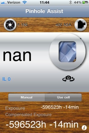

I tried the app but measurement with the camera always results in 0 ev.
Definitly, there is a problem. The strange point is that the video is ok, but the program seems to fails to read the exif data.
Thank you for reporting the problem. I need some more information:
- What is your iPhone/iPod model ?
- What iOS version do you have ?
--> maybe we can continue on private mail.

An update to Pinhole asist is available. It should cure the problem you have, limnidytis.
