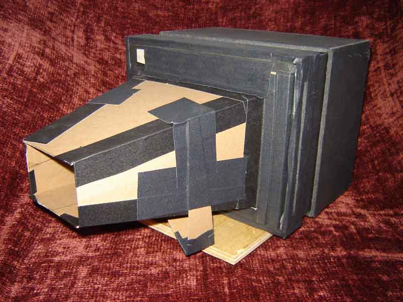

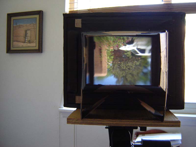

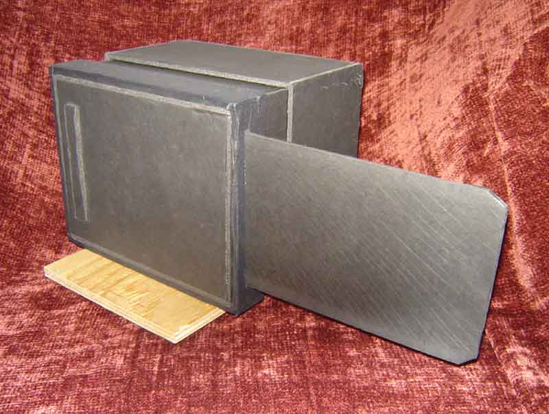

5" x 7" Box Camera
This foamcore box camera used an objective lens from a 7x50 binocular. Since these pictures have been taken, I've converted this camera to use a plastic fresnel lens magnifier as a lens.
Four images of the camera, including the foamcore film holder with darkslide pulled out, and a digicam shot of the viewscreen. The screen is made from drafting vellum paper.
The B/W images taken with the camera are on paper negatives. The first image is with the binocular lens; the second is with the fresnel lens.
~Joe

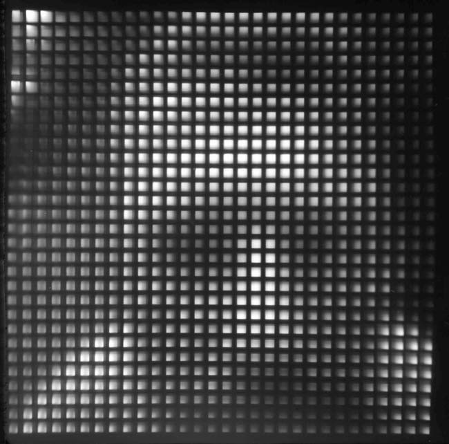

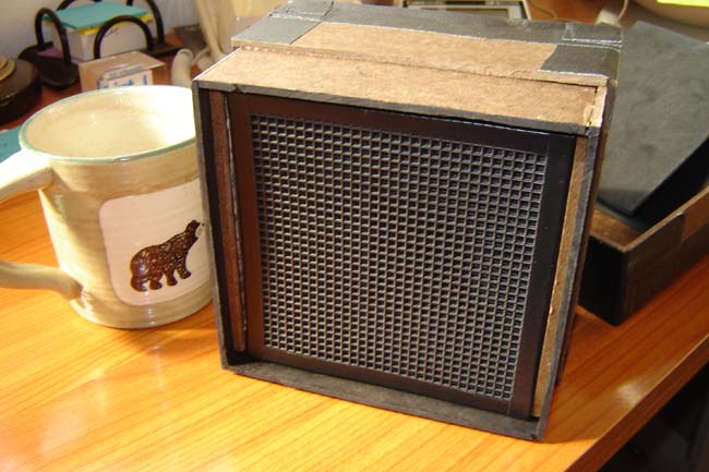

Pixellator Pinhole Camera
This one is weird, even by my standards.
I wanted an analog pinhole camera that would generate in-camera images that appear to be pixellated, to simulate the appearance of a low-res digital camera.
The principle of the camera is that the lens (either pinhole or refractive) projects an image upon a translucent screen (this camera uses drafting vellum). Behind this screen is a pixellator grid, behind which the paper or film negative is placed. Each cell of the grid takes the portion of the image in front of it and averages its intensity into a square pixel of light.
Cardboard camera (basic pinhole camera building method, no magic here) with the pixellator grid at the rear. The attached image is a self-portrait onto a paper negative.
I've also included two sketches which help to illustrate the operating principle of the pixellator grid.
~Joe
