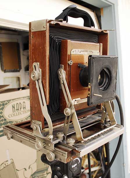

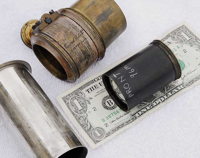

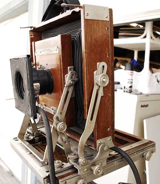

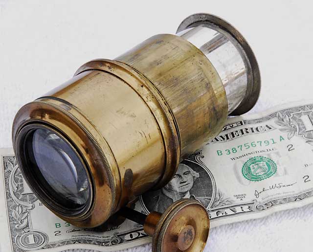

Here's what the original antique lens looks like, it's components, and what it looked like in user mode. I only used the inner barrel with the packard mount for making the pictures.

You said you used the inner barrel when you mounted it in your shutter. Does that mean that all the glass is in the inner barrel, or did you seperate elements? I suspect it's the former.
Steve
jimgalli
jimgalli
Sep 7, 2002
4,236
Tonopah Neva
ULarge Format
Jim,
I'll take it!
The money has been sent.
Steve
Hi Steve. Got the $$. Thanks. Give me a couple of extra days as I'm away on family vacation. I'll get it off to you asap. Jim
Yes, the inner barrel comes out with both ends elements in place properly spaced. JG
