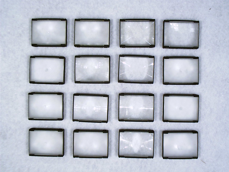

There are 22 view screens available for the Nikon F and F2. I have a complete Nikon set plus a couple of Beattie screens. I have tried them all. Some screens I prefer to others.
When I was young with good eyesight, I preferred the “B” screen for general shooting. As my eyesight failed, I found it easier to accurately focus with the “A” screen or any screen with a split image focusing aid.
For astrophotography, I prefer the “M” screen.
For architectural work, I prefer the grid lines on the “E” screen.
The "P" screen is great screen for general subjects and for architectural subjects; however, I was never able to get used to the diagonal spit image focusing aid. I personally prefer the grid lines and the horizontal split image focusing aid of the "R" screen.
Nikon F2 screens
by Narsuitus, on Flickr
