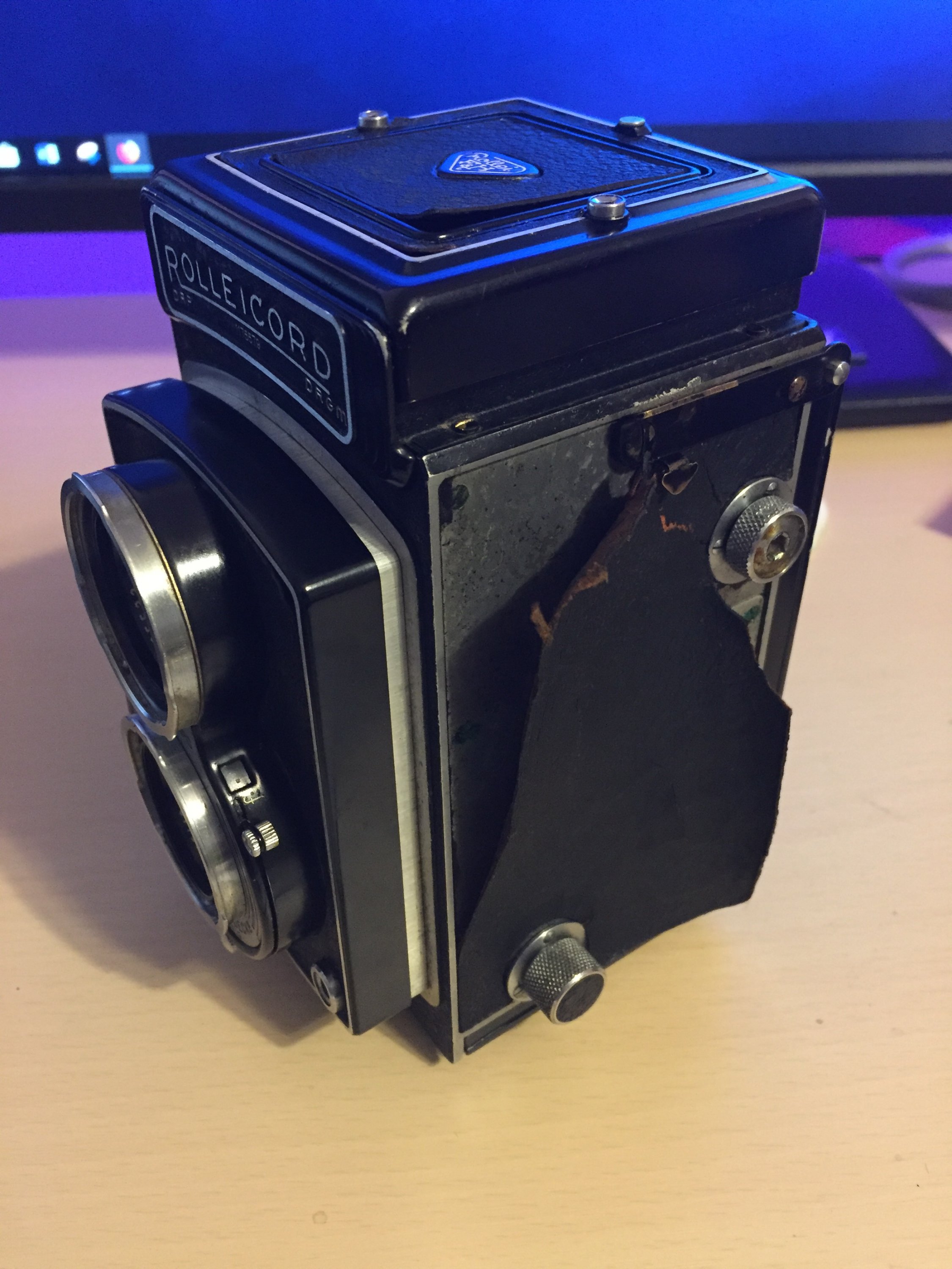

After alternating between baking soda and coffee beans for 10 days, the smell is largely gone; but so is the leather!
Seems the nicotine was the only moisture in the leather and when that left, it started popping off the camera.

As for the leather pealing off, maybe that would have happened anyway, but from what I've seen, there are numerous suppliers of new 'leather' coverings for most cameras available now.
Terry S
Kino
Kino
Jan 20, 2006
7,879
Orange, Virginia
Yes. I have a replacement set bookmarked and hope to have it recovered soon.
I need to clean the shutter first. At least I won’t be worried about ruining the leather now.
