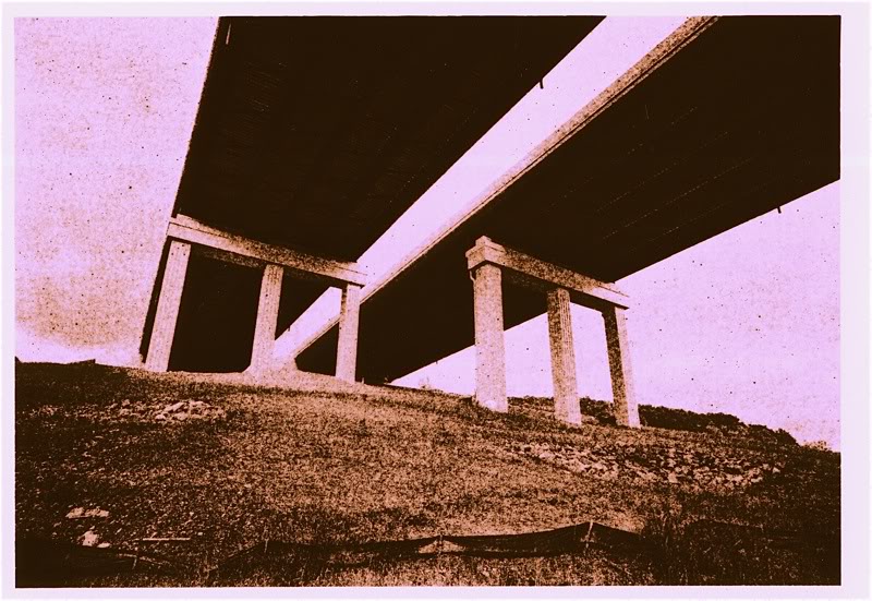

This is a lith print from a 4x5 negative. All the grain evident in this photocopy is from the paper.

What's confusing is he doesn't say Lith printing nor does the title of the thread. The "Infectious development" of a Lith developer doesn't work by increasing grain size though, rather an autocatalytic development of surrounding grains.
