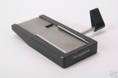

This is what you might want to consider:
Brian is right. Buy one of these Hasselblad slide-in mounts/plates. Used ones on the big auction site are very reasonable, certainly much cheaper than the $150 + $79 from your links above. I am using one of these plates with a 501CM camera. It is solid and exhibits no play.

You’ll see two basic styles- long and short. Get the long one. Easier to mount and dismount. You won’t regret this choice. There’s a reason why Hasselblad made them for decades!
the newer snap-lok have an appeal, but the stupid expensive pricing is just asinine.

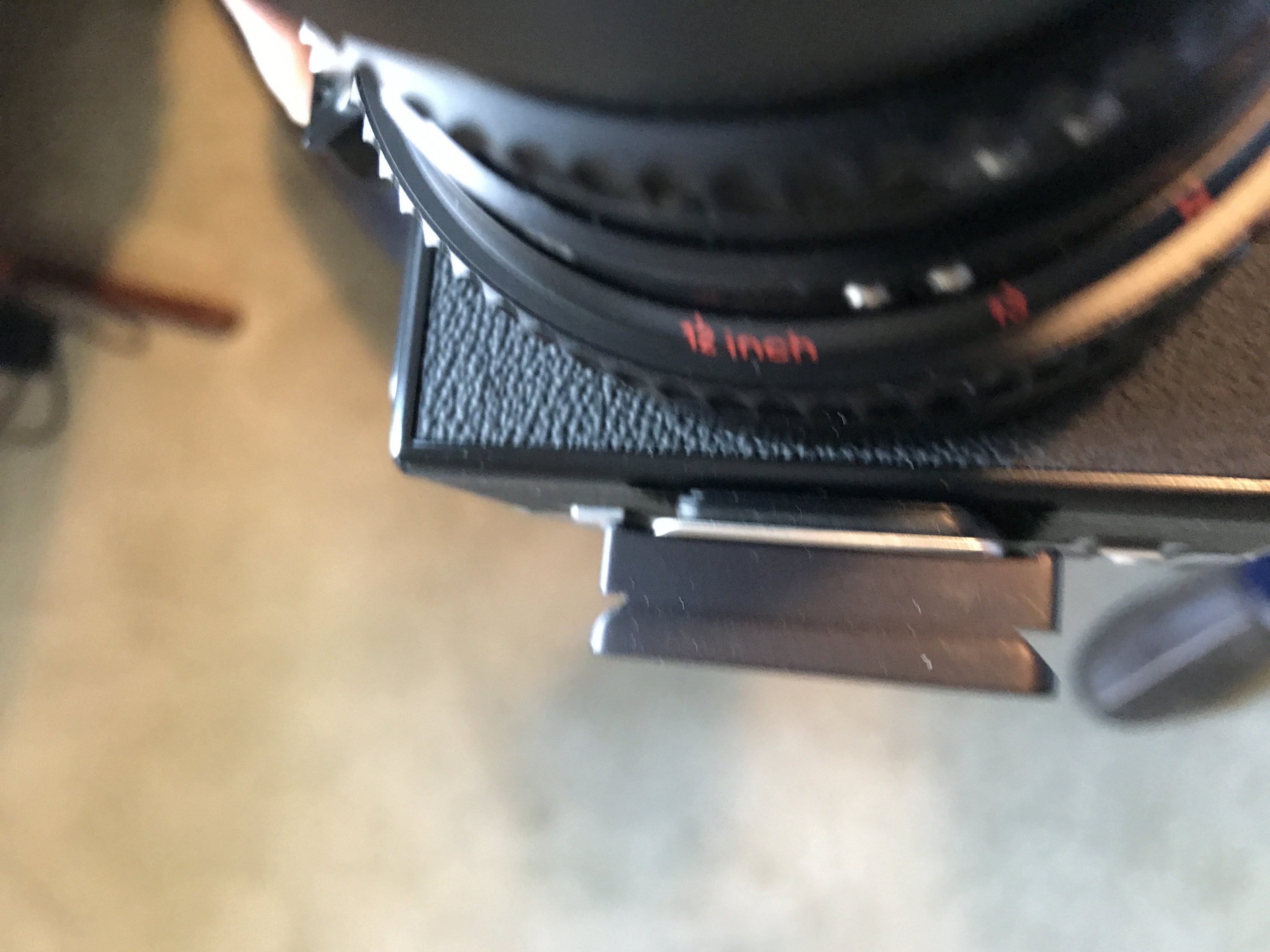

Is this the one you're using?
https://www.acratech.net/quick-release-camera-plates/hasselblad-1-4-20-plate-2144/
I wonder if the lip to prevent rotation will work with the 500C/M. Not much information on the Acratech site about compatibility.

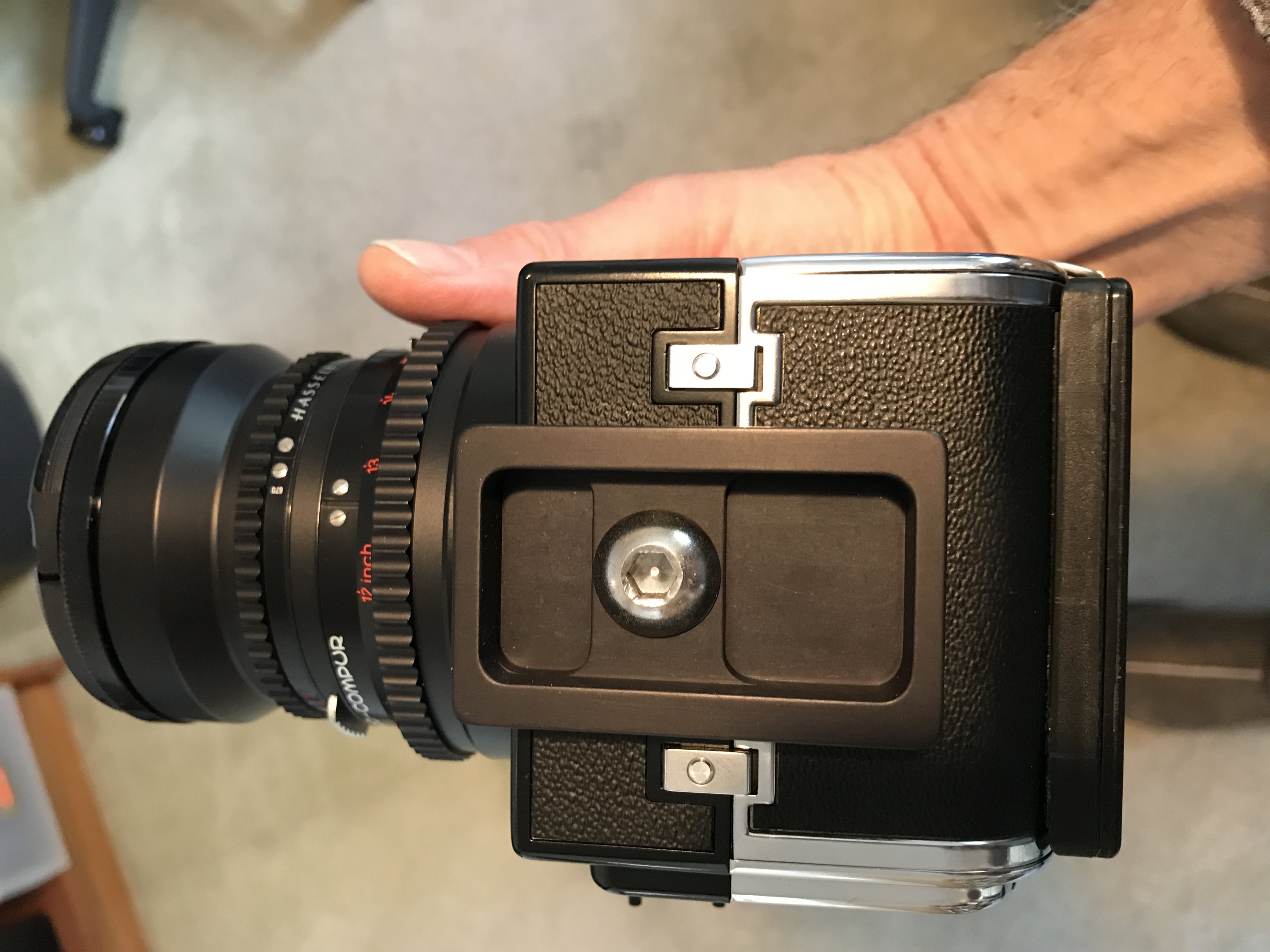

I am using has the larger 3/8" screw one. The same except for the screw size. The one I have is just listed for Hasselblad--I think it fits all 500C and CM, but you can drop them a line to verify.

Well, I broke down and ordered a tripod/ball head/QR plate from B&H as a birthday gift to myself :smile:. I went with the RRS TFC-24L Series 2 Mk. II and a BH-40 ball head. I went back and forth on the BH-40 vs. BH-55 but I don't think I need the heft of the BH-55 and think that the BH-40 will better suit the size of the tripod. Hopefully that wasn't a mistake. I also went with the Acratech 2144 QR plate that the guys at B&H claimed will work properly with the BH-40 - I'm hoping they're right and that the Acratech plate fits the shoe on the bottom of my 500 C/M and prevents camera rotation. If not I'll return it and opt for a different solution.

I received the tripod, ballhead and Acratech QR plate today and it all fits together beautifully. The Acratech plate fits the 'shoe' of the 500CM perfectly and prevents it from rotating. It also fits perfectly in the BH-40. Hoping to get out this weekend and put it to good use.
Thanks again to everyone for their help and suggestions.
