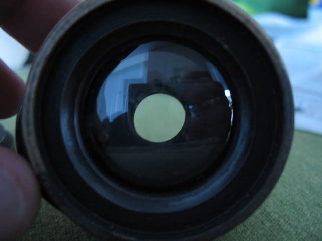

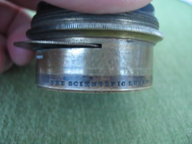

Hi everyone,
I recently acquired a No. 2 Portrait Lens made by the Scientific Lens Co. of New York. It's a brass lens with an internal bladed aperture. There's a slot on the side where you can place a small object (pin) to rotate the aperture to stop down. It doesn't appear that is ever had a rotating aperture ring over this slot. There is a readout along the slot for the aperture. Does anyone have any knowledge of this lens and what type it would have been (Anastigmat, Petzval, etc.)? Any help would be greatly appreciated, thanks!

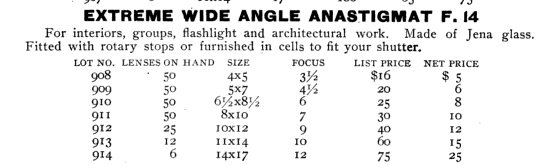

This company had an interesting history, with various owners and names. I think it was started by a man named I have two or three of their lenses. The Extreme Wide Angle I have is quite small and covers 8x10 with no problem. I measured its FL as about 120mm.

I'd be interested in determining the focal length of mine and what size camera it would have covered or been intended for. Unfortunately I don't have a large format camera to mount it to at this time.

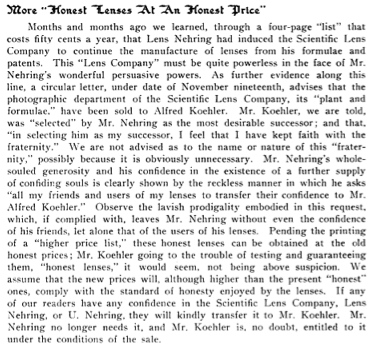

and more. This is from a post on a Yahoo group for lovers of wood and brass cameras. The author is Milan Zahorcak:
The story starts with Ulrich Nehring, the maker of many lens accessories in the 1890s and early 1900s, and involves the Scientific Lens Company (New York) which no one knows much about. Apparently, around 1900 Nehring buys out Scientific, keeps the name, sells off the remaining stock, and spins off U.S. Optical. However, there is some sort sort lawsuit against US Optical – I don’t know what or why, but US Optical loses the appeal – and then US Optical and maybe U. Nehring both disappear
