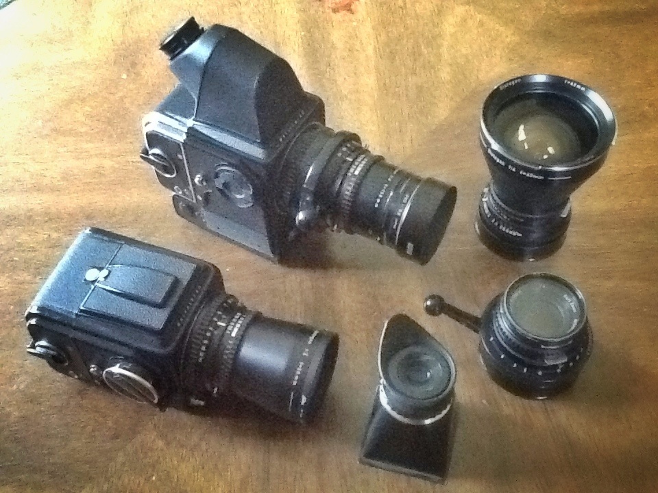

To get into Hasselblad for less money, motorized elm and elx bodies can be had for $100-150. Add a 500cm later when a good deal pops up.
