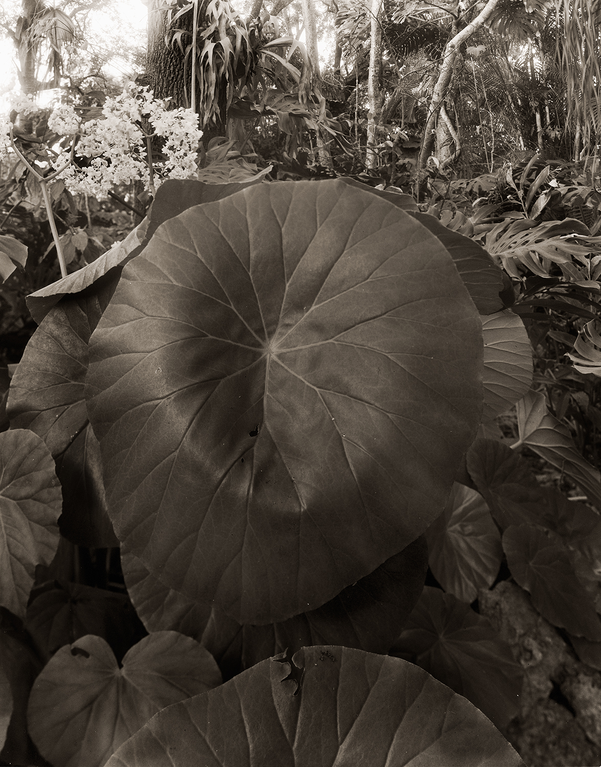

I'm not into the mechanics s o I went with the Ilford Titan. With their shorter cone they suggest F206. I imagine the specs are online. They also had a handy exposure dial that I printed and plasticizes and assembled. I take an incident reading and interpolate. I figured out a reciprocity table for HP5 -my go to film I print most of the negatives as pt/pd contact prints. Here is an example
http://www.jeffreyglasser.com/
http://www.sculptureandphotography.com.
pbromaghin
Sep 30, 2010
3,775
Castle Rock, CO
Oh, my. NEVER seen a pinhole photo that was so clear.
jeffreyg
Jun 12, 2008
2,588
florida

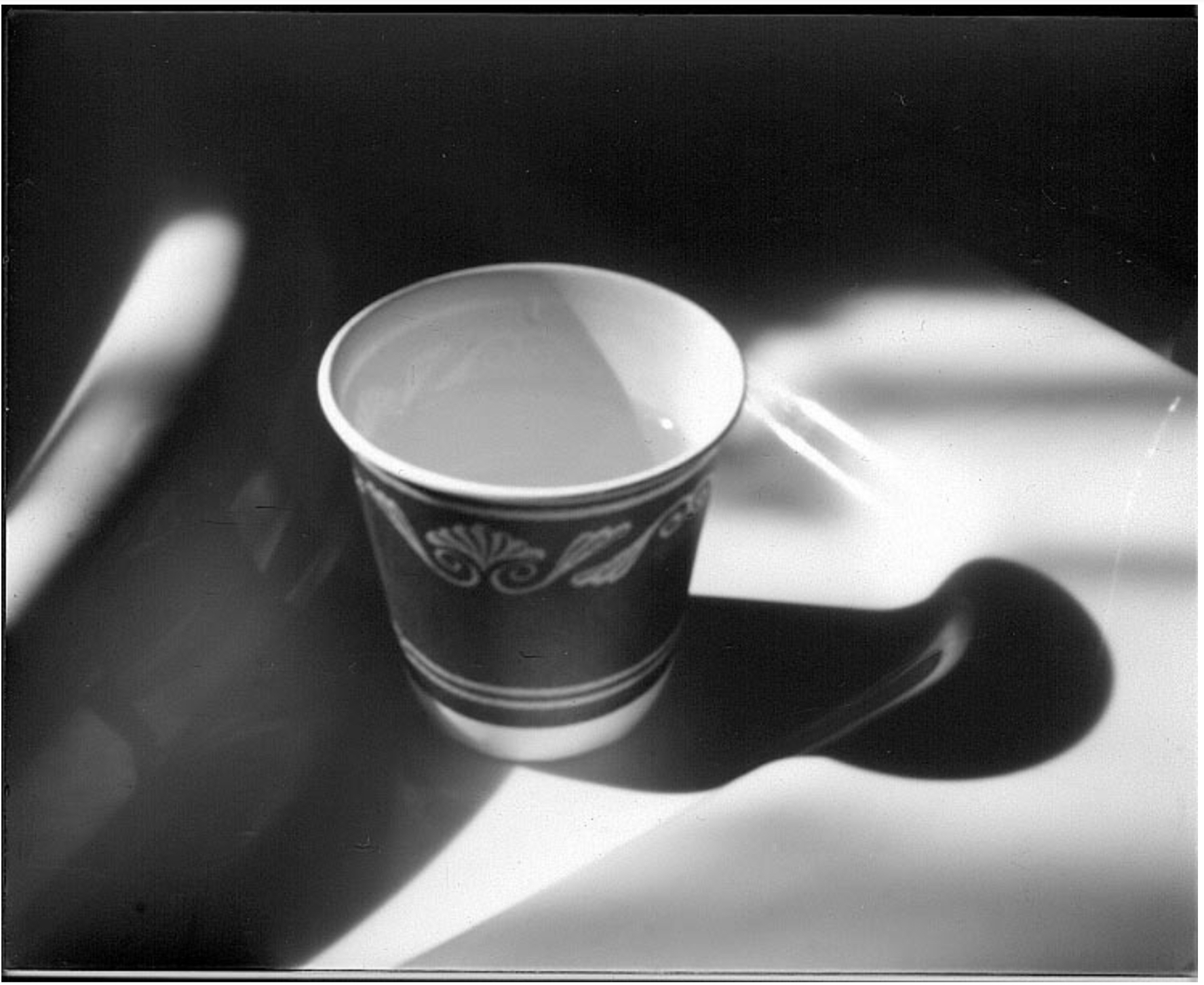

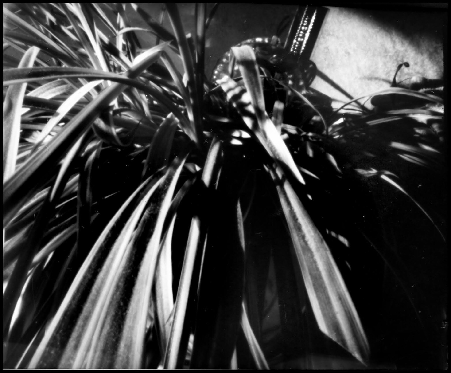

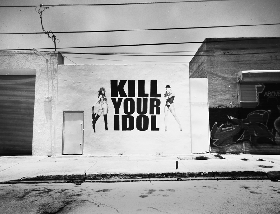

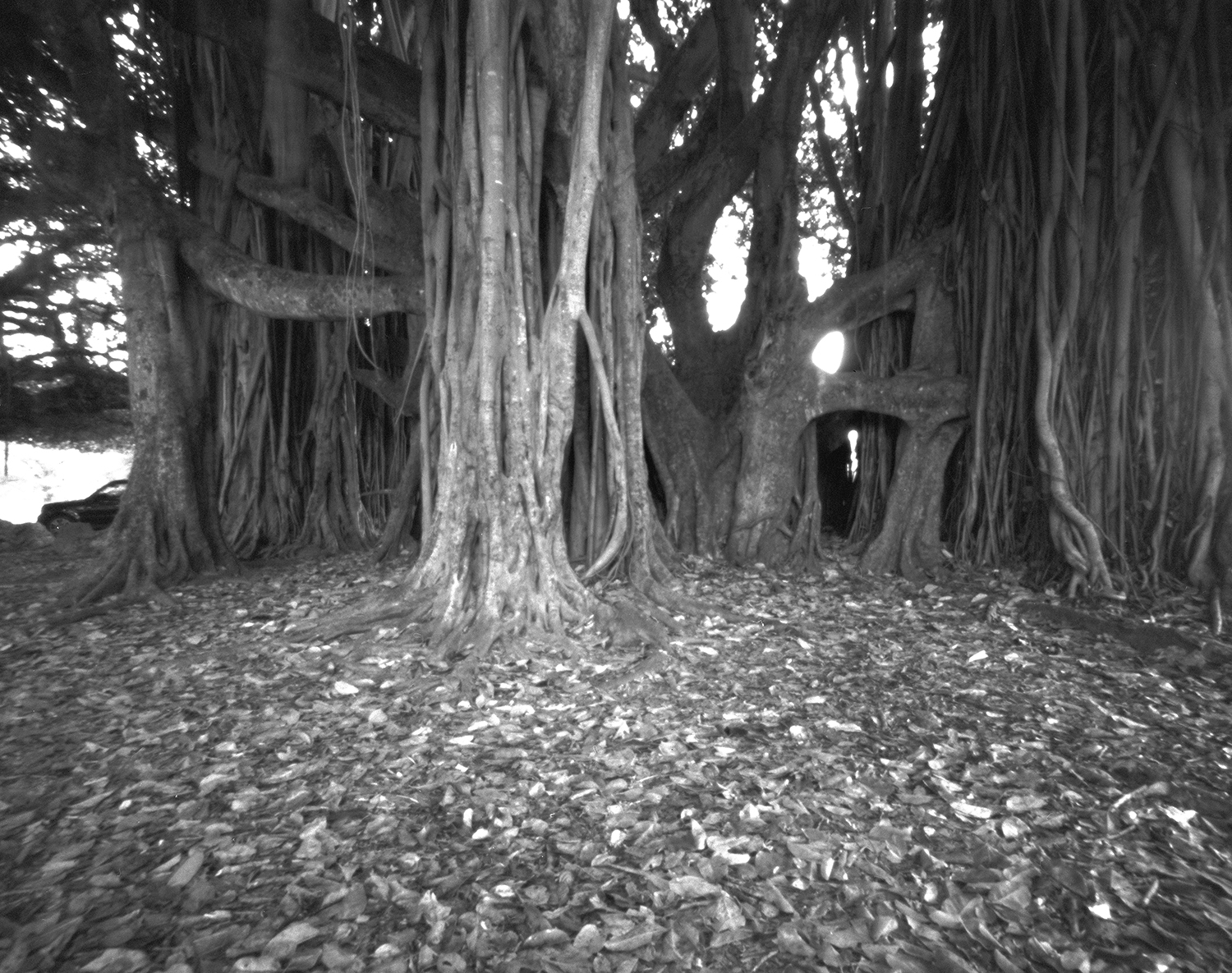

Thanks. It was eary in the morning and dead calm. 4x5 film and a very sturdy tripod. Here is another.

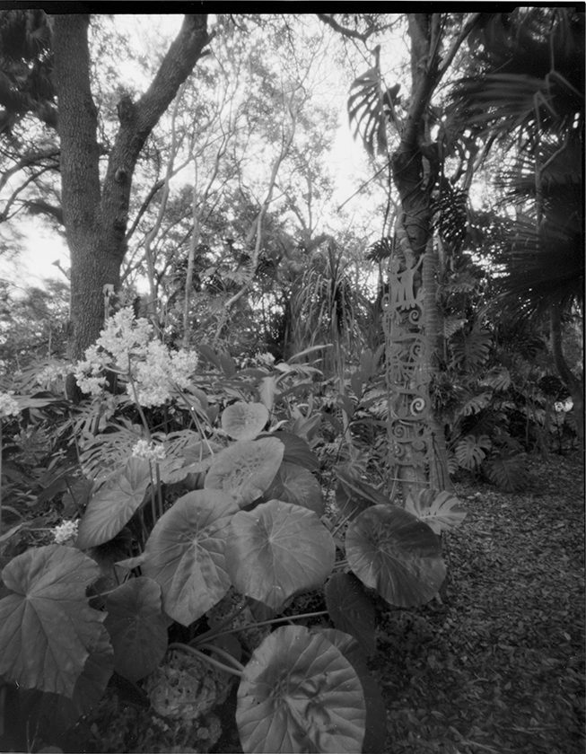

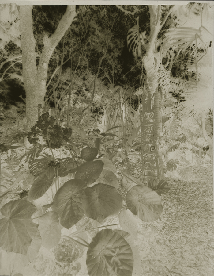

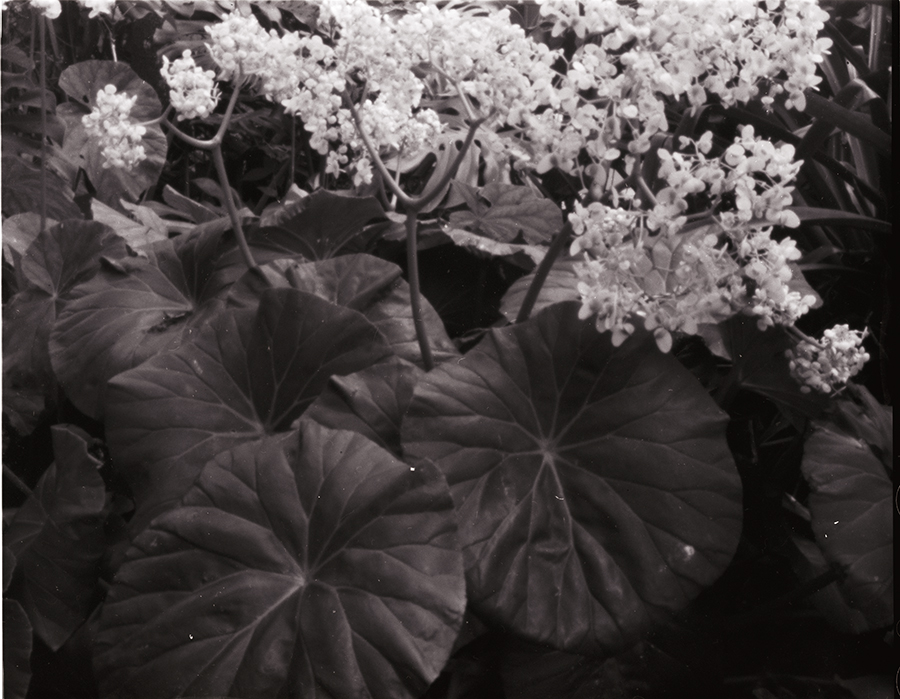

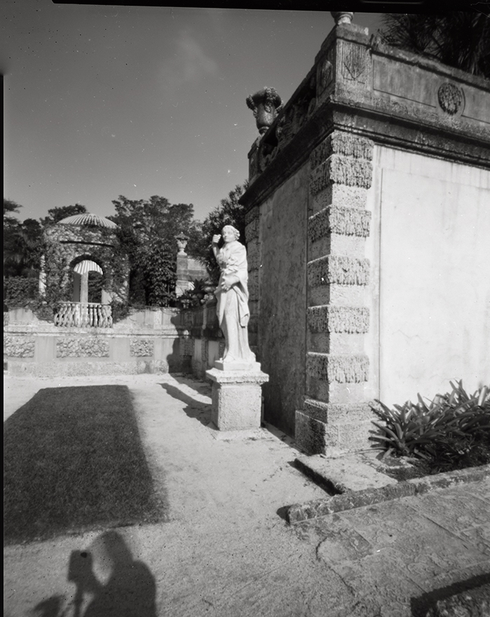

A couple of coments appeared tom to indicate the begonia leaf image was not legit. I Never misrepresent my work and I do use my real name. I recently retired after 58 years of practicing dentistry and during that time i had photographs in 60 exhibitions the most recent of which was a one person exhibition at the IPC ArtSpace curated by Carl Juste a Pultizer Prize winning photo journalist also in previous years on the Hasselblad and Ilford websites, in Black&White magazine several times and printed a limited addition series of images in platinum/palladium for an internationally prominant photographer. Here are a couple of images from the same session (all in my back yard) as the begonia leaf and one that i happened to be a shadow with as you can see the Titan on my tripod. All on HP5 scanned with SilverFast Studio 8Ai
http://www.sculptureandphotography.com/

Hope you didn't think my comment wasn't inferring anything. It wasn't meant to. As a current practicing dentist I have a harder time believing you were able to practice for 58 years! There's no way I'll be able to do that. I'll be deaf from the drill by the time I'm 60!
For some strange reason I see two different images here, when the wording seems to imply there should be just one.
I can understand why people are amazed by the quality of the begonia negative - but other than the possibility of jeffrey posting the wrong file in error (and not noticing), I certainly wouldn't doubt his veracity.

The additional begonia images are: one and it's negative image and another separate image. The three total images : the original that sparked the comment, a positive and negative and the third horizontal. All exposures were made in my back yard on the same morning one after another. We don't have dead calm that often. It was early in the morning shortly after sunrise. We have a large yard with close to two hundred trees with a natural canopy. I didn't mix up any files. I had to go back and scan the negatives to make the posts.

Jeff - I didn't think the begonia related images were mixed up, but I was confused about the "Kill your Idol" and "Ficus" images in post #16, which accompanied the words "Here is another" (not "Here are two more").
jeffreyg
Jun 12, 2008
2,588
florida
Sorry about any confusion I clicked the ficus as a thumbnail but posted the kill as full image
