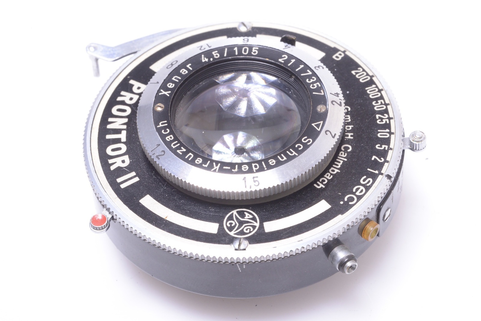

Some Prontor shutters have a plastic ring, that I assume is for insulation, next to the flash contact. Inside is just metal with a tiny hole. What is the purpose of this? I have only seen it on Prontor shutters so far.

I presume you're referring to the part that looks like "natural" urethane just next to the PC sync connector? I think I recall reading this was a secondary connector for a particular kind of flash cable -- used the PC sync plus the terminal inside that ring. Since PC sync stands for "Prontor/Compur" this may actually be an obsolete part of the PC sync standard from the 1940s or 1950s.

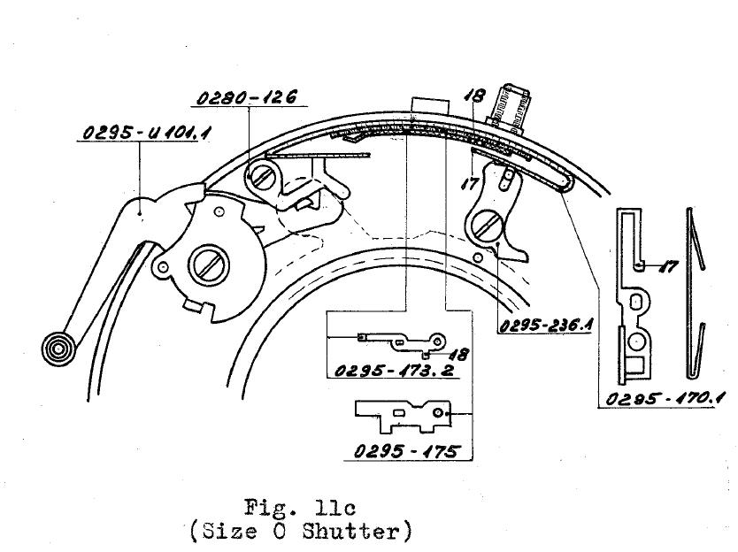

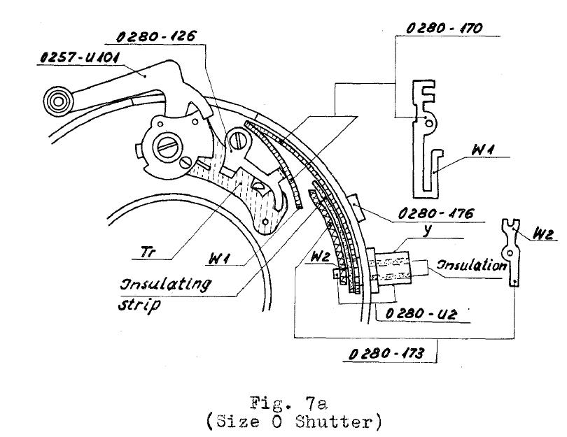

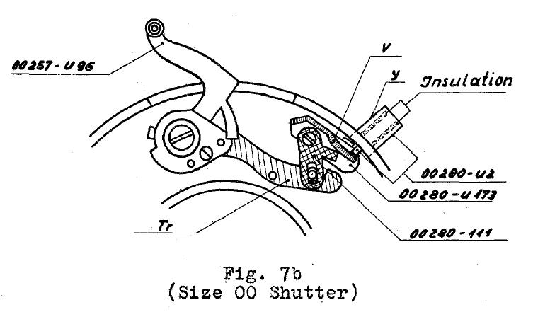

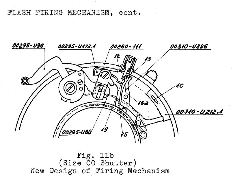

https://drive.google.com/file/d/0B1sPJkp-MdghVFNtSzhyay1lTkE/view?usp=sharing
There are multiple variations of this shutter. The one in question is a early version. The flash contact strip is connected to the case and insulated by the plastic piece in question. The parts section of the manual shows it as part of the case, not a separate part. The contact strip is connected to the center of the PC socket and is contacted by a spring or part of the delay mechanism depending on the variant of the shutter.
