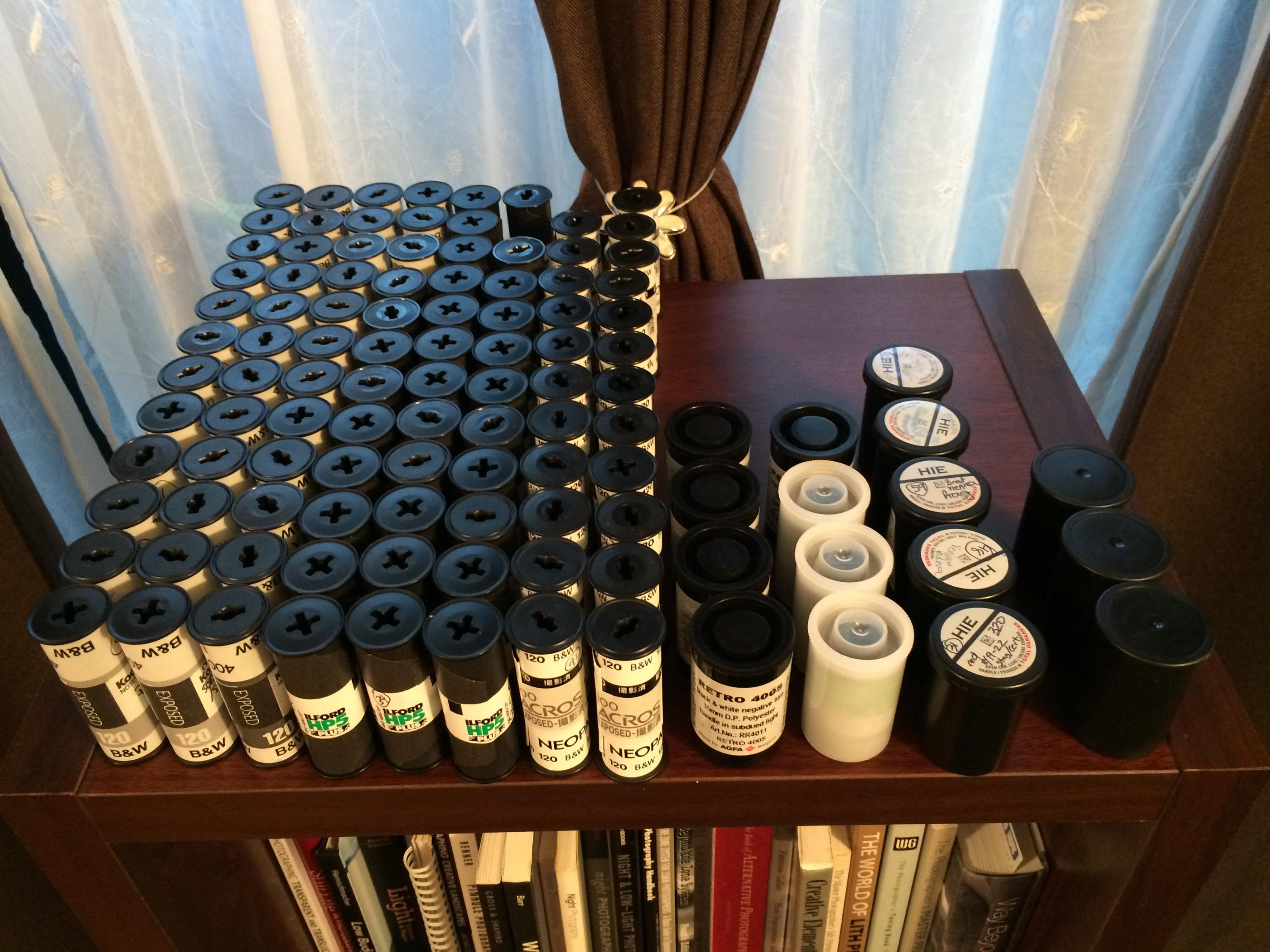

...is coming back home to 100+ rolls of film to develop!
At best I can do 8 rolls a day, (2 rolls x 4 sessions) but the reality will be more like 4 with everything else I have to do. I usually shoot some colour which means I can drop it off at the photo store, but this trip was black and white only so I'm responsible for everything. I've never had such a backlog before - it's a little daunting!
