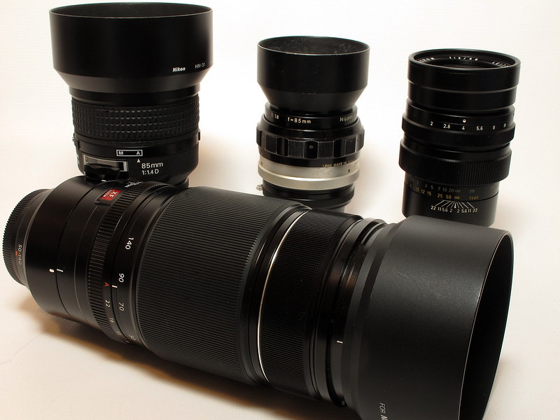

I own both. I purchased the 85mm f/1.8 back in the early 1970s. It was the second lens I purchased for my Nikon F bodies (the 35mm f/2 was the first).
Years later, I had Nikon AI it.
Decades later, I purchased the 85mm f/1.4 primarily for the auto focus to use with my F4, N70, and auto focus digital SLR bodies.
Slightly telephoto lenses
by Narsuitus, on Flickr
