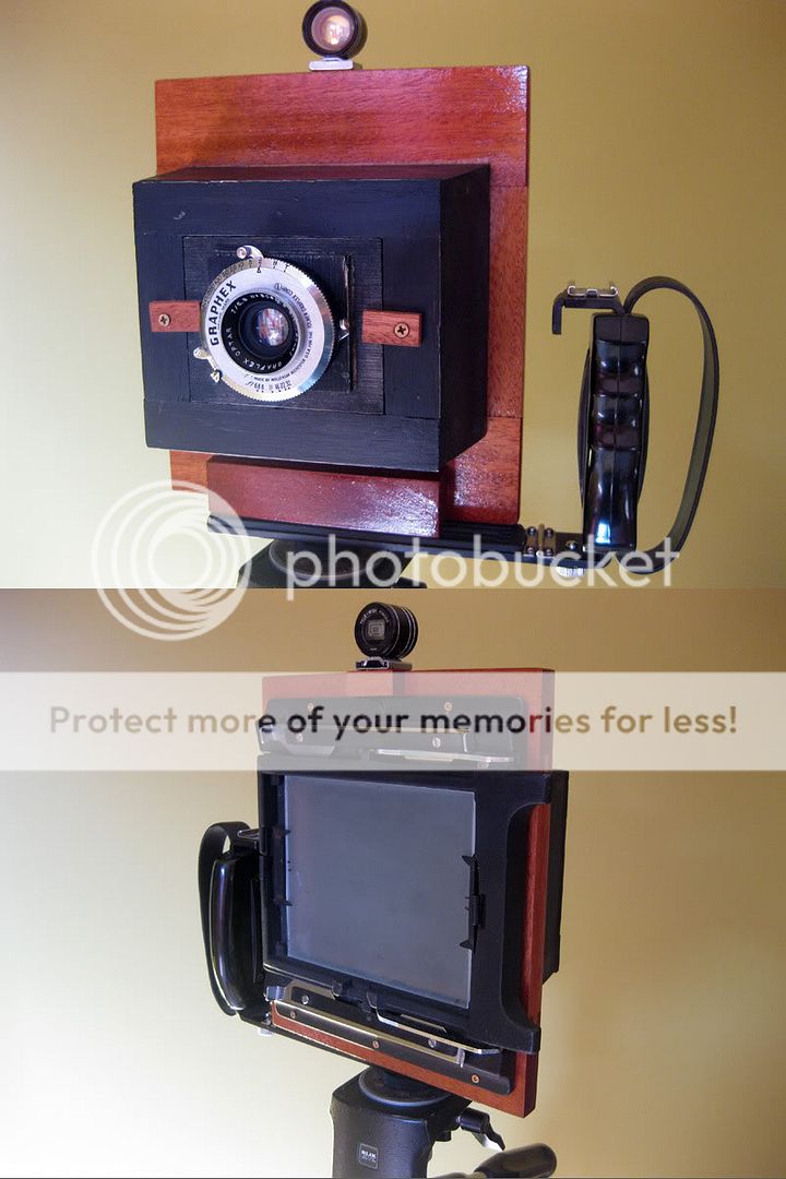

A few years ago, I took some direction from Sandeha Lynch and built myself a 4x5 hyperfocal point-and-shoot camera. Based on his design (and his name for it), the Neretta is/was a fun project. But, it got set aside, and stripped for parts, lens was sold, yada yada. So the body sat in a drawer for a couple years.
Well, I recently got a bug in my ear telling me to bring it back. Bought a new lens - an Optar 90/6.8. Bought a new bracket handle. Refinished the mahogany. Ended up with this:

Is there any focusing involved or is it set at hyperfocal distance?
Steve.
bliorg
bliorg
Sep 20, 2006
683
NW Philly, PA
Thanks, Steve. It's hyperfocal. Focus is set at about 12'; at between f/22 and f/32, I've got about 5.5' to infinity.
