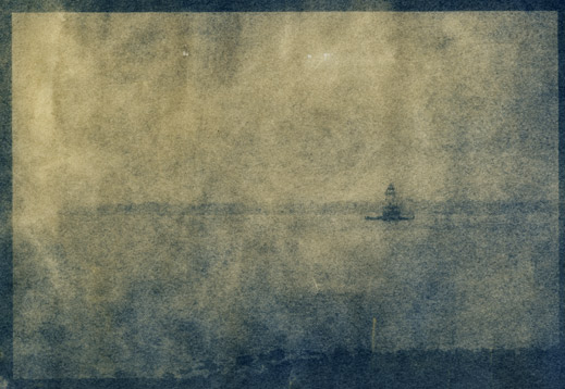

i uploaded a cyanotype i made this way ... its printed on something about 8x10
the colors aren't blue because i bleachback and paint my cyanotypes.
i can't remember the time it took to expose, it was winter and there was a lot of reflected UV from
the snow on a sunny day ... i've printed a lot of things this way as a cyanotype using paper negatives

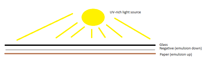

This is not the forum for discussing the process of making digital negatives. That said, the process of exposing them is identical. Inside the contact printing frame, you'll build a sandwich with the glass on top, then the negative, emulsion down, then the sensitized paper, emulsion up, then the pressure plate at the bottom of the frame. See the attached diagram-
attachment.php
Thank you for this info!
