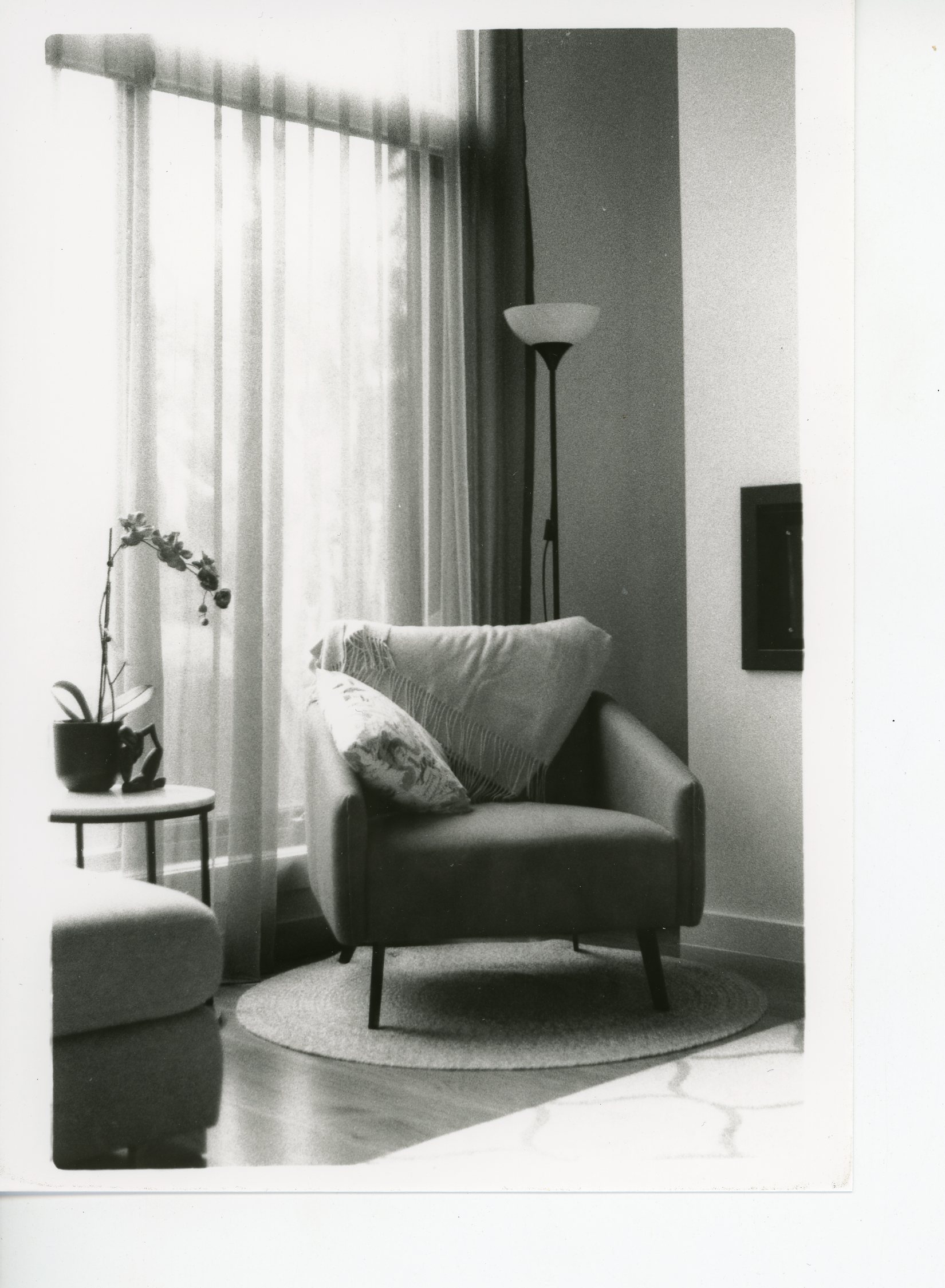

For a little background, I am a HS student who is trying to combine a love of film photography and chemistry by undertaking experiments with Chris Patton's E-72 ascorbic acid paper developer recipe for a final chemistry report. I'm using a 1+1 ratio, with no phenidone, so vitamin c is the only supposed developing agent (sodium sulfite 22.5g, ascorbic acid 9.5g [IV], sodium carbonate 45g, potassium bromide, 0.95g in a one-liter working solution).
The independent variable I am changing is the concentration of ascorbic acid (the dependent variable being the effect on the final image, though how I am quantifying that is a problem for another day). For my control group, I put no ascorbic acid into the developer solution.
To my total surprise, the image still developed. Albeit with very low contrast, but it was more than I was expecting (a blank sheet of paper!). I am not sure what happened, chemically. I had a theory one of the other components must have reduced the silver, but haven't found much evidence suggesting the other chemicals do this. I couldn't find too many others who are mixing developers..without developing agents.
Does anyone happen to know, or have any theories, about why this happened?

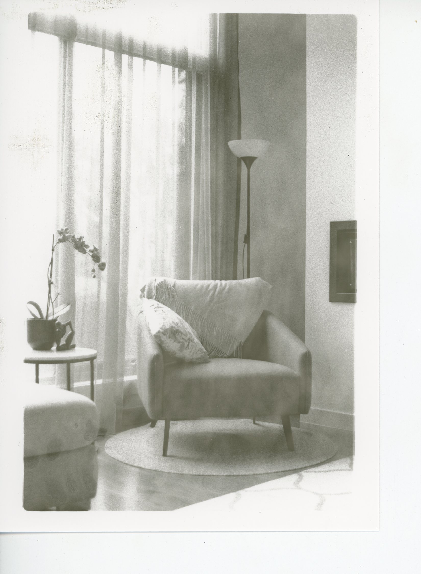

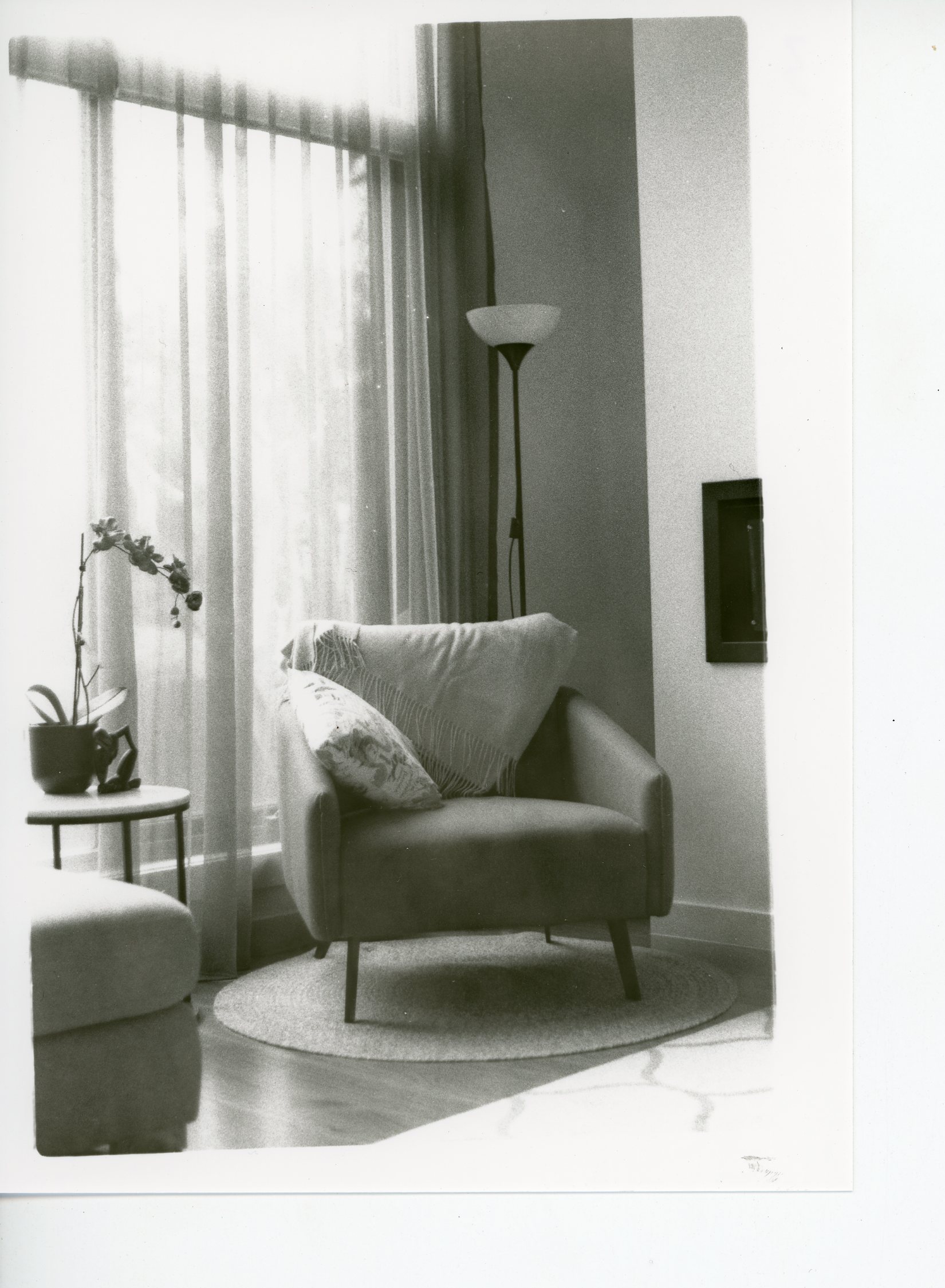

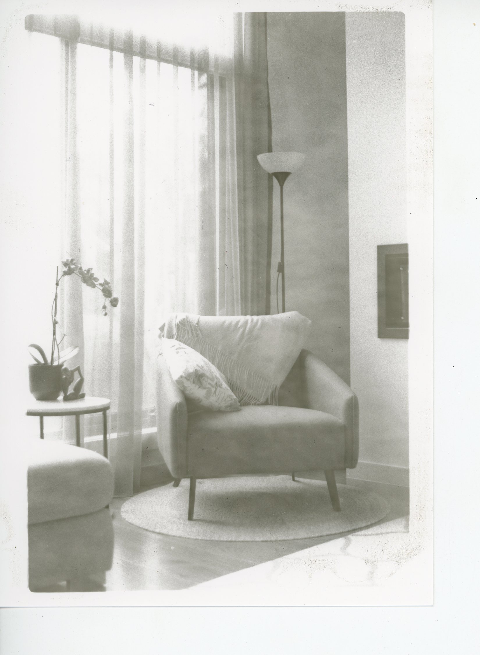

My scanned prints in order: 0g, 0.1g, 1g, 4.5g ascorbic acid (all with 8s exposure, f8, 60 sec in developing solution)
Many thanks!
A slightly stressed chemistry student
