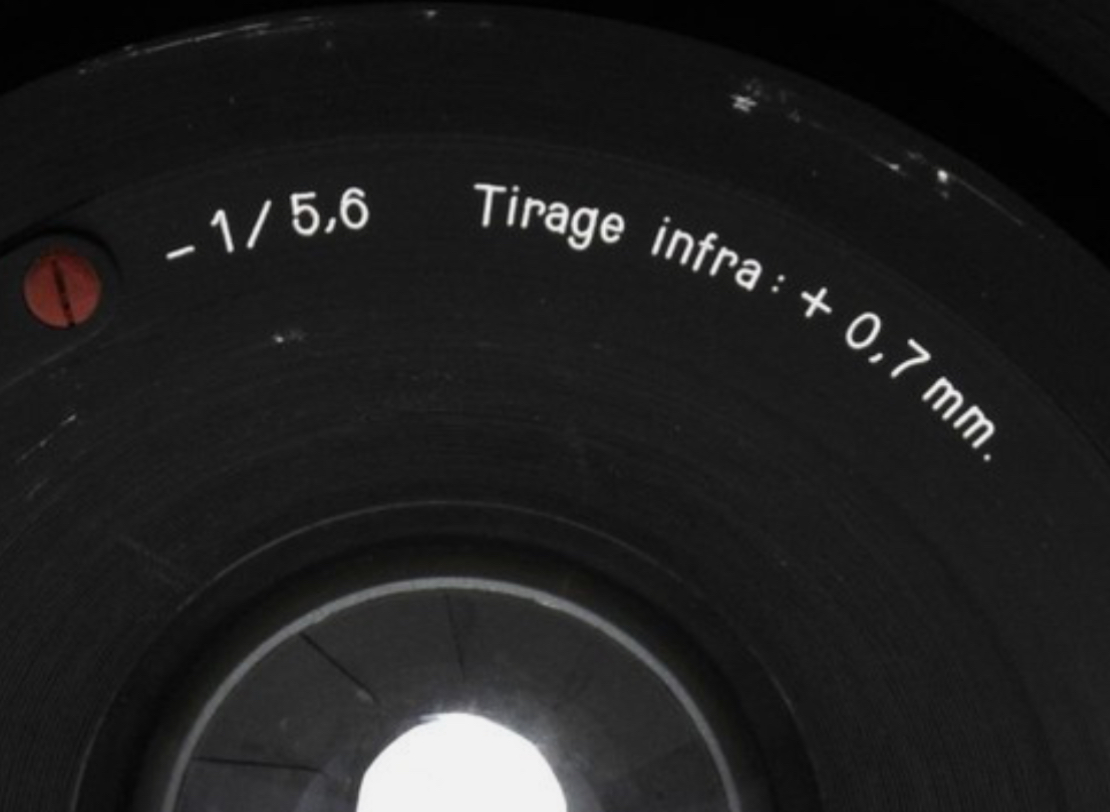

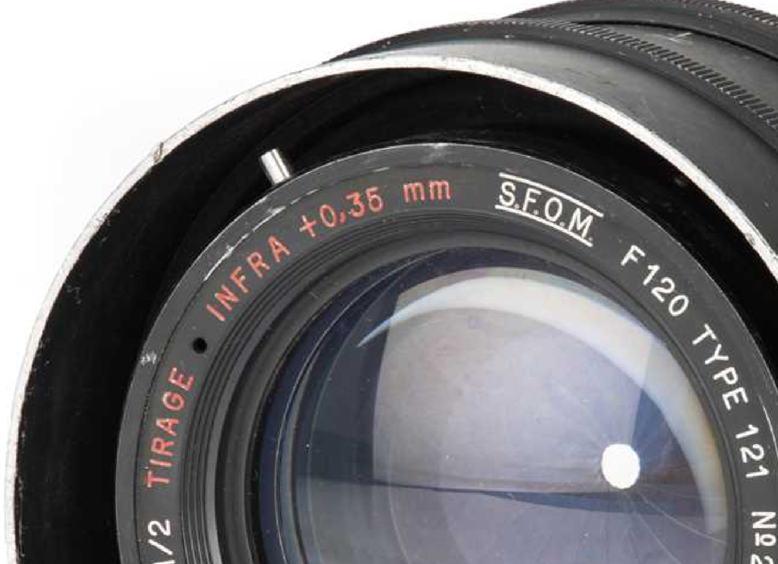

I have noticed that some SFOM lenses have a specification printed on the lens, that other lenses do not.
Typically, you find focal length, aperture and maybe coverage printed on it.
But on these lenses, you will see printed:
Tirage Infra: +0.35mm
or:
Tirage Infra: +0.7mm
I am going to assume that it refers to infrared? Does that mean these lenses do not correct chromatic aberrations and thus are are not suited for full spectrum photography?
What does this distance refer to? A correction offset when focussing? A delta in focal length when it projects infrared light?
OAPOli
Sep 26, 2022
687
Toronto
"tirage optique" in French means "back focus distance". "Infra" likely for "Infrarouge" i.e. infrared. This is the offset distance required to compensate for focusing infrared light.
