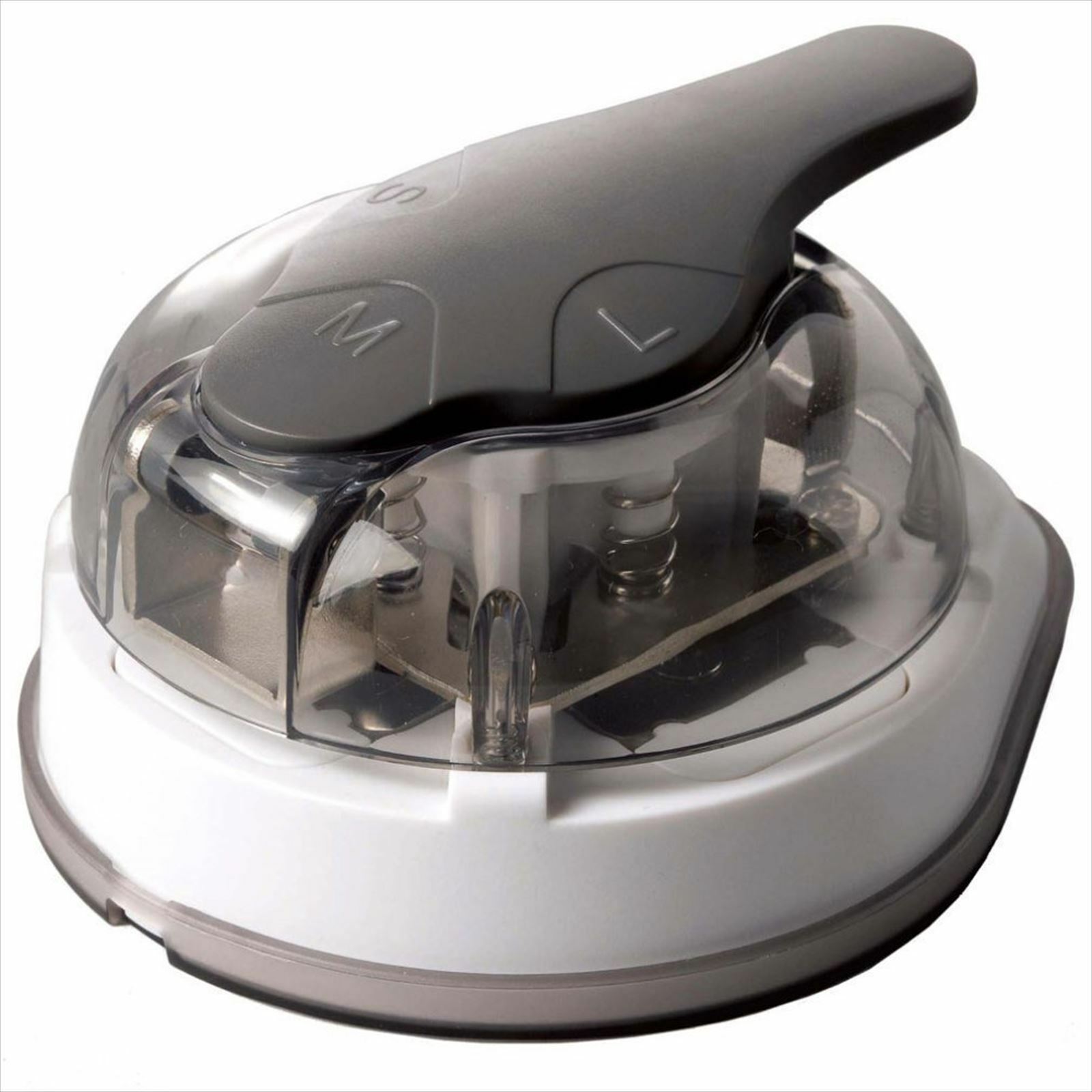

SUN-STAR Kadomaru Pro Corner Cutter - easily round the corners of film for easier loading onto plastic reels so it doesn't bind.
Michel Hardy-Vallée
Michel Hardy-Vallée
Membership Council
Apr 2, 2005
4,794
Montréal, QC
That is amazing! I usually cut a round end to my 35mm film using scissors, but this is next level.
