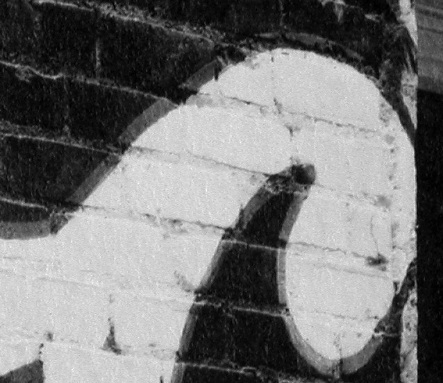

As it happens, I haven't shipped the Traveling Portfolio yet, so I have the print in hand at the moment, and looking with a 6x loupe, I don't see any pepper grain on Alex's print using your Azoish coating on Strathmore Smooth. I made a quick digisnap with my Coolpix 990 that mostly lives on a copystand for archiving documents, and at the camera's maximum magnification closest focus I couldn't see any either. I've attached a crop of the file showing an area about 20mm across from an 8x10" print. I've only adjusted levels and used a slight amount of Smart Sharpen in CS2 to match the print as best I can.
For scale, this would seem to be a full print from the same neg (but on Azo G3)--

Thanks David for the independent opinion. I'm glad there was none there. I was pretty sure I had none at all in the Azoish emulsion, but it is good to hear that verified by others.
