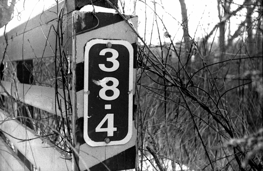

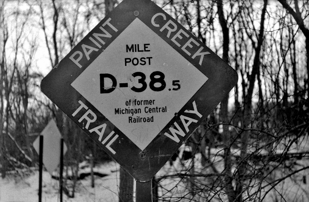

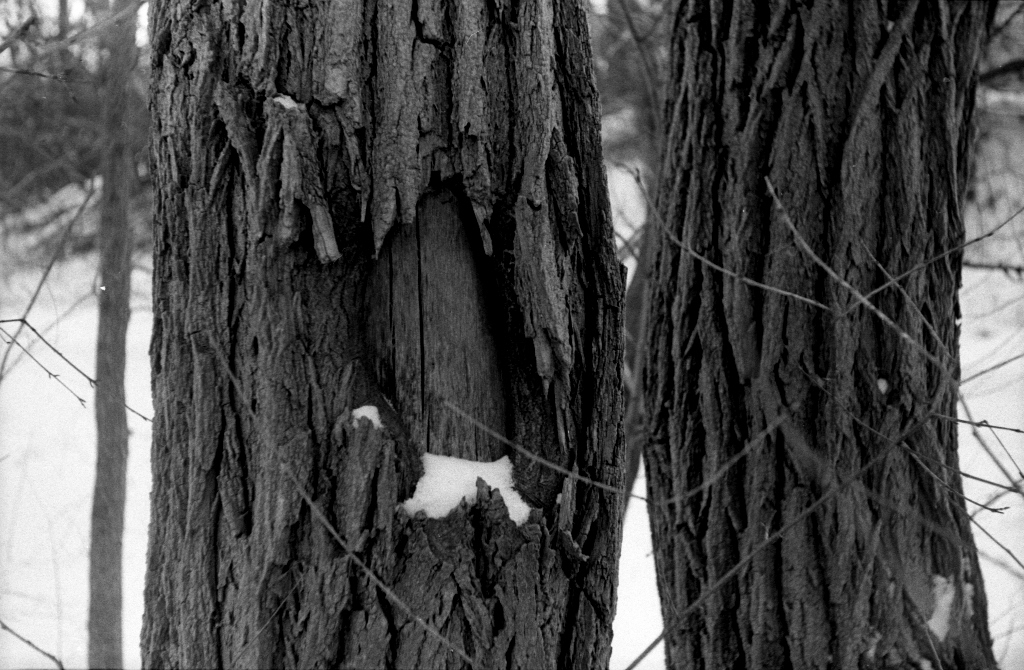

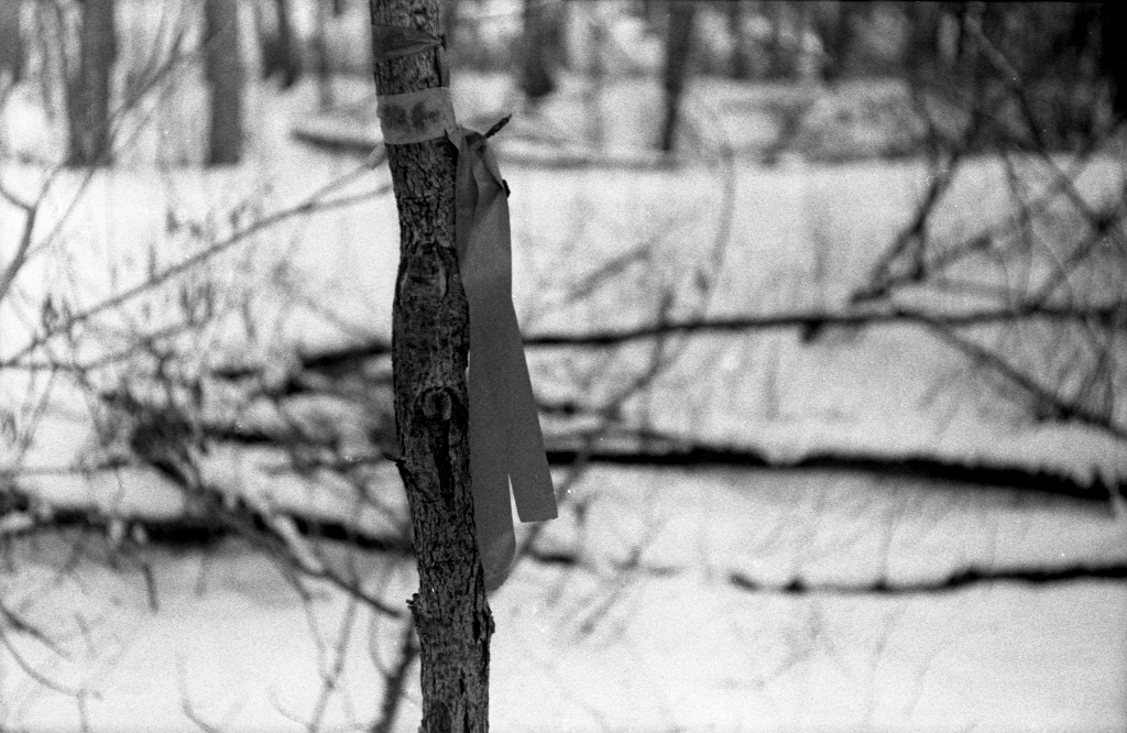

The Wollensak 50mm f/2.8 Velostigmat lens was a very popular offering from Wollensak during this period. It is a simple triplet, but shows good edge sharpness at f/8 and smaller. At wider apertures, it shows swirly bokeh characteristic of this type of lens. Film was Kodak Tri-X 400 developed in HC-110B:
1/100 f/11:
1/100 f/11:
1/1250 f/4:
1/200 f/5.6:
1/100 f/5.6:
1/50 f/8:

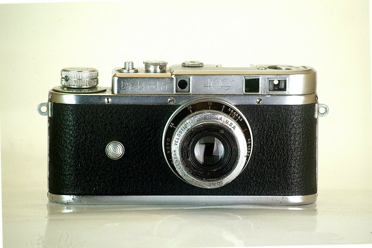

I recently picked up a very clean Detrola 400, an american made rangefinder/leica copy. I became interested in finding one having seen it in a 1940 Sears camera catalog. I collect Sears Tower brand cameras and with some research discovered this is a super rare camera with only around 800 made. Many had issues with the rangefinder mirror becoming unglued in the summer heat and were returned, then they went out of business, so the number "in the wild" is probably much lower. I haven't shot any film with it yet but the sample I got does work and while not mint, is pretty clean. I can say my Leica IIIa is a MUCH nicer and smoother operating camera. It's not even in the same league quality wise but it is a nice looking design.

The Dtrola also has a 38mm mount. Leica had patents on 39mm.
The Detrola 400 definitely has the most similar looking handling to a Leica based on appearance, I have never handled one. There's actually one on eBay right now with about 4 hours left. I was bidding on it early on, but now it's up to $442, too rich for my blood.
