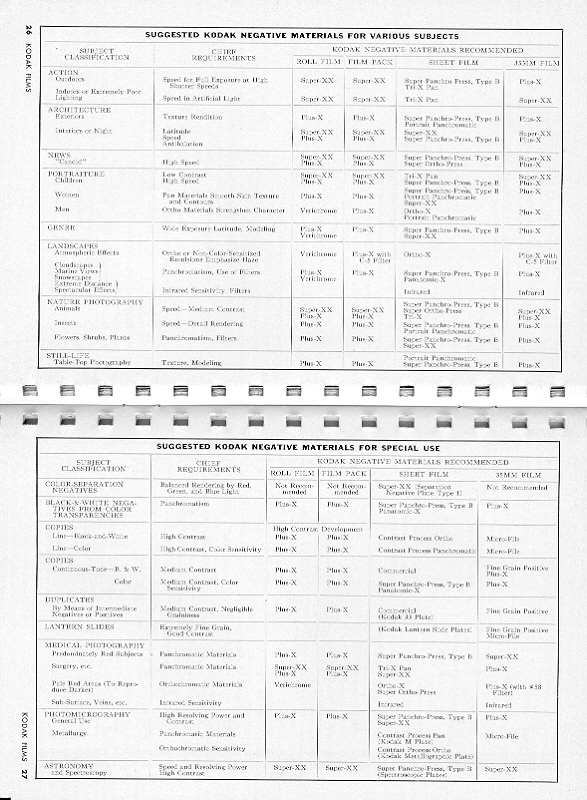

Primarily, there is the choice of film stock and the use of flare-prevention techniques in taking. In a photograph that includes an overcast sky, there will unavoidably be an increase in flare, which will affect shadow densities most of all.
Films intended for outdoor/multipurpose use (e.g., old Super-XX) have a short toe, which tends to fight the flare to a certain extent. Film intended for studio use, where flare is much lower (e.g., old Portrait Pan, Ektapan) generally have a longer toe. Using such films outdoors under high-flare conditions tends to yield rather weak, soft shadows.
The number of films available has been severely reduced over the last 15 years or so. The variation in curve types has also been reduced.
See attached.
See attached.
The contents of the page are really not that important. The page is simply a listing of various Kodak films with the applications for which they are best-suited. The point was the wide variety of Kodak films available for specialized purposes in 1950. Among the traits these films had was differeing toe characteristics, which determines whether they should be used under low-flare or high-flare situations.
Should have said so, I can go along with that. I have a few tech manuals I can refer to along similar lines now that I can see your point.
