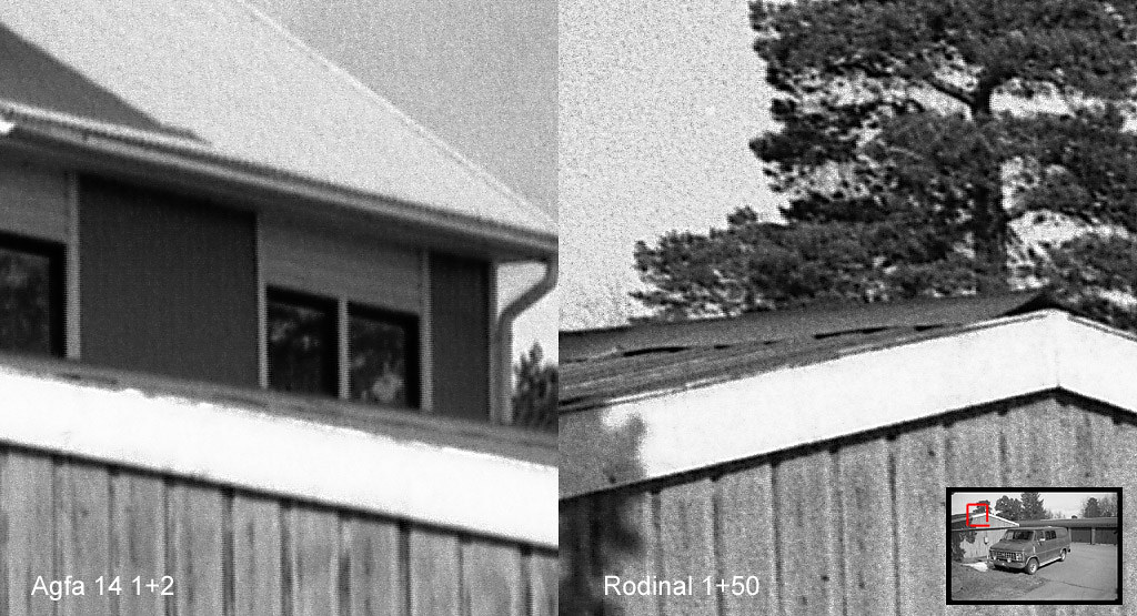

I have tried a similar developer, Agfa 14:
4,5 g Metol
85 g Sodium sulfite, anhydrous
1,2 g Sodium carbonate, monohydrate
0,5 g Potassium bromide
It's soft working fine grain developer, and almost to opposite to Rodinal when developing the old, real, Agfa APX 100. Just by looking at the negatives you can easily tell it's not an accutance developer... It gets better diluted 1+2.
I have never tried D-23, but I have always wondered how it can produce negatives similar to D-76 and be very sharp when diluted 1+3, when a developer like Agfa 14, and probably the Dulovits formula, which also have Metol, but less sulfite, struggles with sharpness.
https://live.staticflickr.com/1273/4711177019_c884e22ac4_b.jpg
