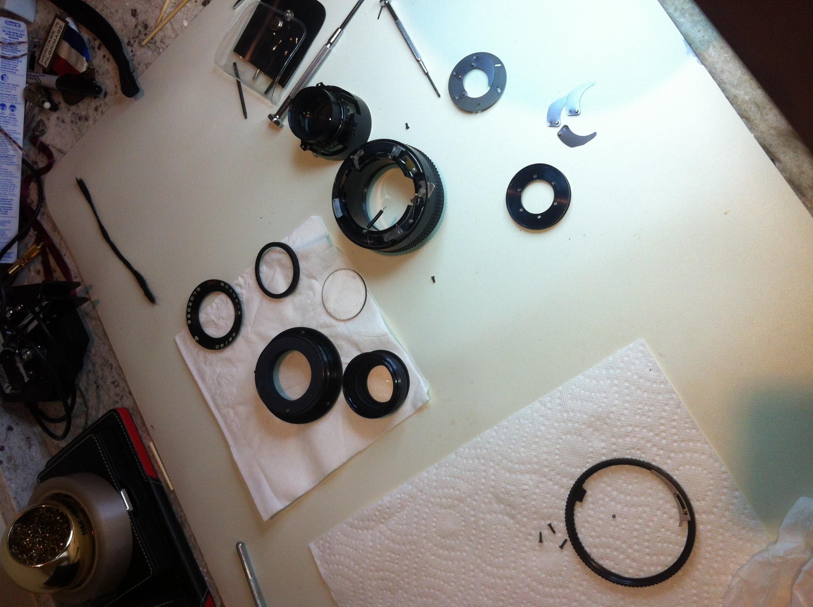

I disassembled and cleaned the lens. It was definitely gunked. grease on the diaphragm blades, grease on everything. Also took the opportunity to make all the glass squeaky clean. Works great now!
(I have no idea why Apug decided to rotate these images 90 degrees CCW...)
View attachment 72313View attachment 72314
Did you take them and post them from an iGadget, iPhone or iPad? The iStuff automatically rotates to the proper orientation, but sends the files unflipped and other displays don't make the automatic change.

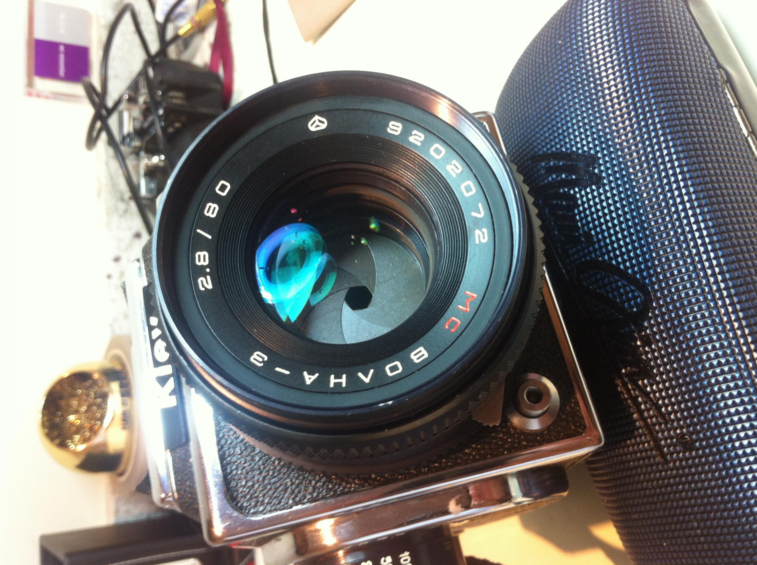

I was kind of inspired by this thead, thought I'd take my MC Volna out for a spin today. I don't tend to use 'normals' too often, even if I've got more of them than any other (80volna/90vega/80biometar on P6 and 40/50/50/50/53/55/55/58 on 35mm).
Stuck it on my 88CM, one back of Kodak Pro 160 and one back of 400Tmax, visited my 104yo grandma in her nursing home. Only took a few shots though, be a few weeks before I finish either roll...
