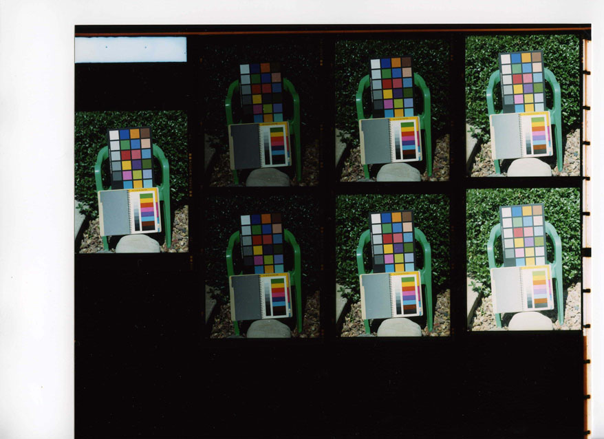

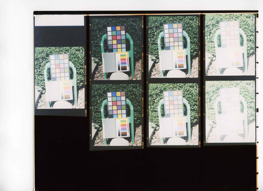

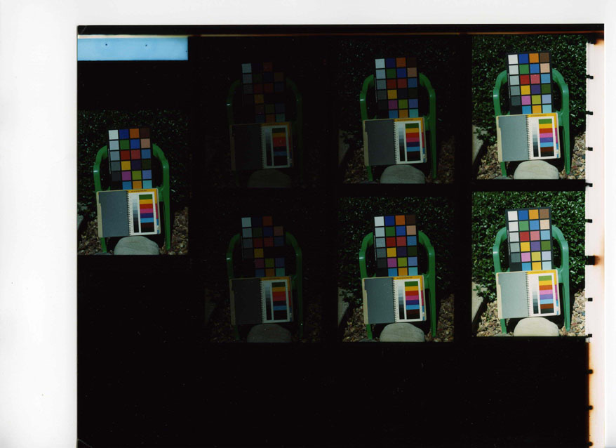

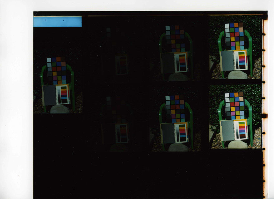

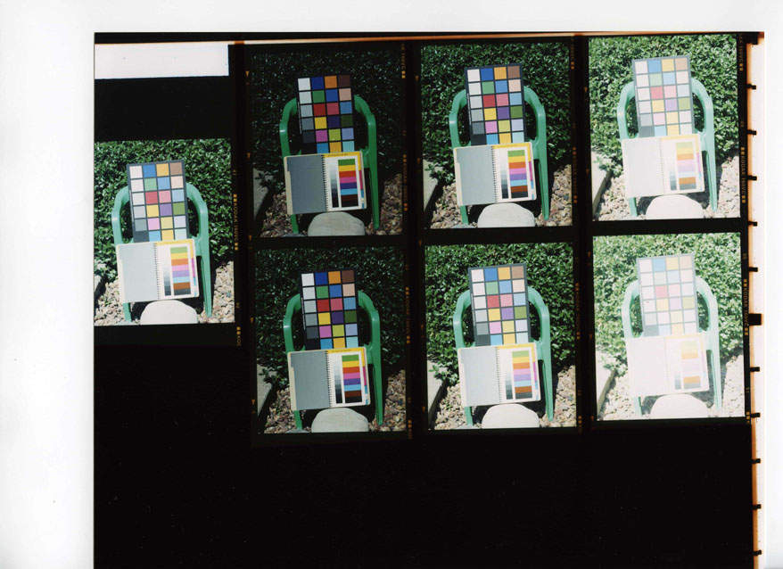

Here is a series shot on 160 VC and processed with normal development times.
They are scans of contact prints on Endura paper with constant exposure time (12") and only the f stop was varied.
The exposures in order are leftmost normal ISO 160.
Second column ISO 25, 50 (top, bottom)
Third column ISO 100, 200 (top, bottom)
Forth column ISO 400, 800 (top, bottom)
You can see visually the huge latitude. I did the same test on Portra 400.
Shot with an RZ67, prism meter on auto.
PE

Well, my point in the photos above was that there is a 1 stop latitude leeway in which you do not have to push or pull. Just normal processing with a 1/3 overexposure will probably give you the best of all possible worlds with any format of a given negative film.

This is 1 roll of 120 film exposed at (from L to R top to bottom):
ISO 160 - reference, 25 - t, 50 - b, 100 - t, 200 - b, 400 - t, 800 b.
These were then contact printed onto Endura paper at 12" with one stop increments from f5.6 to f22. The film and paper were processed normally. Due to the changes in f stop, the paper should show at least one image that is "correct" or nearly correct for the ISO rating. The result shows that usable or even quite good pictures can be obtained from about ISO 50 to about ISO 400. And, no push is needed.
So, all of the sheets have the same ISO rating, just a different printing exposure to "highlight" the best frame with the "right" ISO for the amount of light given during printing. The bottom line is that negative films have a huge latitude without push or pull processing and usually look best about 1/3 stop overexposed.
PE
