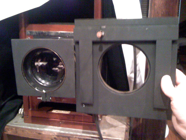

One aspect of modern ULF field cameras I don't like is the smallish lens boards. For some of us, the field camera does double-duty as a portrait/studio camera, and it's quite necessary that it take some rather large old lenses (and the large Packard Shutter that goes along with them).
I agree, I like plenty of room in front too, I would rather use an adapter board on a larger front than try to put a lens on a front that is obviously too small. I have two Packard shutters but never had the space to fit one behind a lens and use them with any of my cameras.
If you're DESPERATE for mounting a packard shutter on a big lens, you can always do what I did... I made a "universal" front-mount system. That camera is a Gundlach Wizard 11x14, with a Bausch & Lomb 1C 16" f4.5 Tessar. AKA big-ass lens. I just have to make a new face-plate for another lens and I can transfer the packard to it. The Gundlach takes an almost 7" lensboard, which is what I'd consider to be the minimum size for a field camera. Nice would be a 9", but that's getting too big for a field camera.

That's what I call ingenuity Scott, what a great solution.
