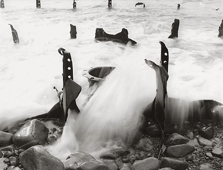

Here's a couple of quite different examples:

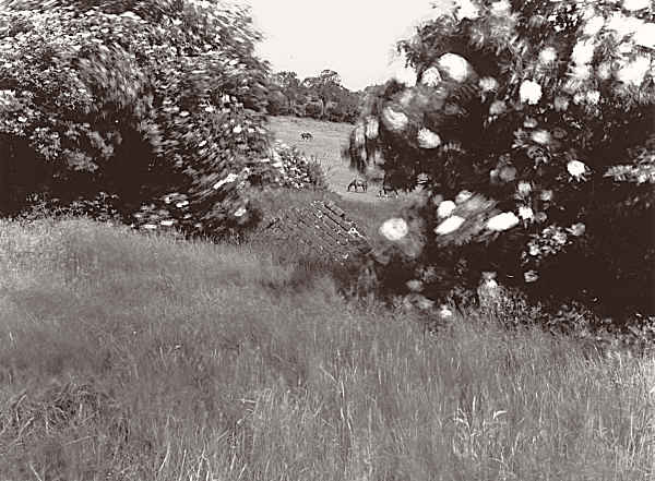

and
The first is just long enough to show movement of the water, but not too long or all the sea would fluid . . 1/4 sec
The second, apologies for the poor scan, is a long exposure made up of fragments, so overall 8 seconds, made up of multiple exposures 1 sec, 1/2, 1/4, etc, this stops the movement in the trees & grass from just being a blur. The print is approx 24"x30" and some of the grass plus the brick work is very sharp.
