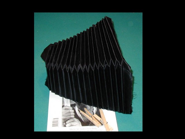

I have also gone the Porters route using their premium blackout cloth and used file folders for the stiffeners. I then used a China silk product as the inside liner. I tried using car headliner spray glue to attach the liner to the blackout cloth and found the glue too thick. It almost came out like silly string. The bellows is for a 4x10 camera I am building, about 14" extended, but since I made the bellows about 3/4" too tall, I have to rebuild the rear standard. I also made an expensive mistake by cutting the bellows without a glue flap rendering the material too small. I hope I have enough for the 7x17 camera I hope to build next year.
I spent most of my time doing the layout on Autocad (big relearning curve) and probably cutting the stiffeners. Don't be intimidated by the folding, if you have the layout and stiffeners done properly, it almost folds itself.
Good luck
Eric
