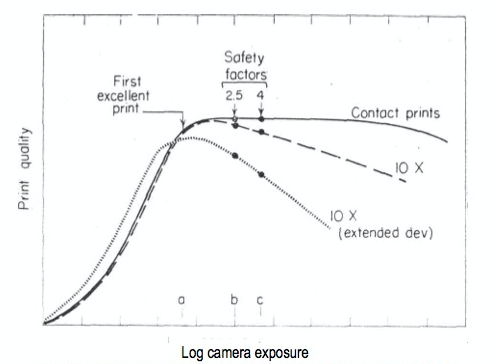

Yes, Bill, with the popularity of smaller formats and the desire to hand-hold the camera in the 50s onward, the two lower curves became more important. If you ask me, the situation was never adequately addressed until the advent of matrix metering in the late 1990s.
Safety Factors in Camera Exposures
PHOTOGRAPHIC SCIENCE AND ENGINEERING' Volume 4, Number 1, January-February 1960,
