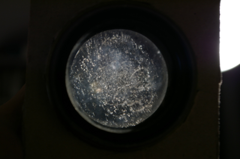

I wanted to see what all the fuss about these old lenses was about so I bought a lot with 4 of them from swedish ebay. included was a old brass ground glass loupe and a light meter which from my understanding of the manual has you counting seconds while you watch a bit of POP turn grey. I have bought the Vademecum but I was hoping some of you experts could tell me more about these lenses.
Anyway the lenses are:
1. Ross London Anastigmat 1:8 WA F. 150mm "Zeiss Patent". Its a tiny little thing. , the closest Zeiss equivlent I have found seems to be the Protar Series III, but that is f/9 not /8 like this one. It seems to illuminate 8x10 at infinity but Ill have to test if it covers with film someday.
2. "ALFA Dubbel Anastigmat f:6.8 210mm Import" I have no clue what this lens could be, it could be rebranded by some company called Alfa for the swedish market or anywhere else where we spell double like dubbel.
3. Schulze & Billerbeck, Berlin "Euryplan Serie V F:5 No5 F=270mm" I read in the Vademecum that the Euryplan is the forrunner to the modern plasmat, this is a large lens. Something has happened to it however, there are a lot of scratches and cracks inside it. There are some big cracks and a lot of small ones that didnt show in the image that are uniform and form a pattern like you would see on dried up mud. See the attached image or link.
4. Emil Busch "Rapid Aplanat Ser.D F:8 No4 F=340mm" This is the best one cosmetically.
I set up a page with some test shots. A want to apologise in advance however for the poor scanning. This is the best I could get out of this machine with the included software. Dead Link Removed
I would appreciate any information you have about these lenses and if you have a copy of any of them please post an image from it.

The Ross/Zeiss f/8 WA - might that be a Protar ser. IIa? Two elements in frint, three in the rear? It's not likely to be a III (f:7.2, 2+2) or a IIIa (f:9, also 2+2)...
A "Dubbel" Anastigmat f:6.8 is likely to be a Dagor-type or similar, most 3+3 fully cementes double anastigmats tyrn out to be Dagors or reverse Dagors.
The Euryplan is, as the VM says, a precursor of the Plasmat. Yours seems to have badly decomposed cement.
Emil Busch Rapid Aplanats are great. That may well be the sharpest lens of the whole lot!

I really dont know if the Euryplan is totally unusable, I made this image wide open. Its a terrible scan but you can see it looks a bit like a normal lens with a soft filter or a stocking. The highlights bleed in to the shadows. I think it could be useful in some situations.

it's soft-focus and low-contrast. Looks interesting enough that you might want to place a few inquiries as to the cost of repair- I have no idea how much you have invested in it, but if it isn't much, it could be worth having that bad cement redone. You'd definitely get a boost in overall contrast from it, which would be a good thing.

The Euryplan is, as the VM says, a precursor of the Plasmat and a very good lens when in good glass conditions. I have some in different focals and also a very rare casket set that in use are excellent. Yours seems to have badly decomposed cement as one of mine that is very similar.
